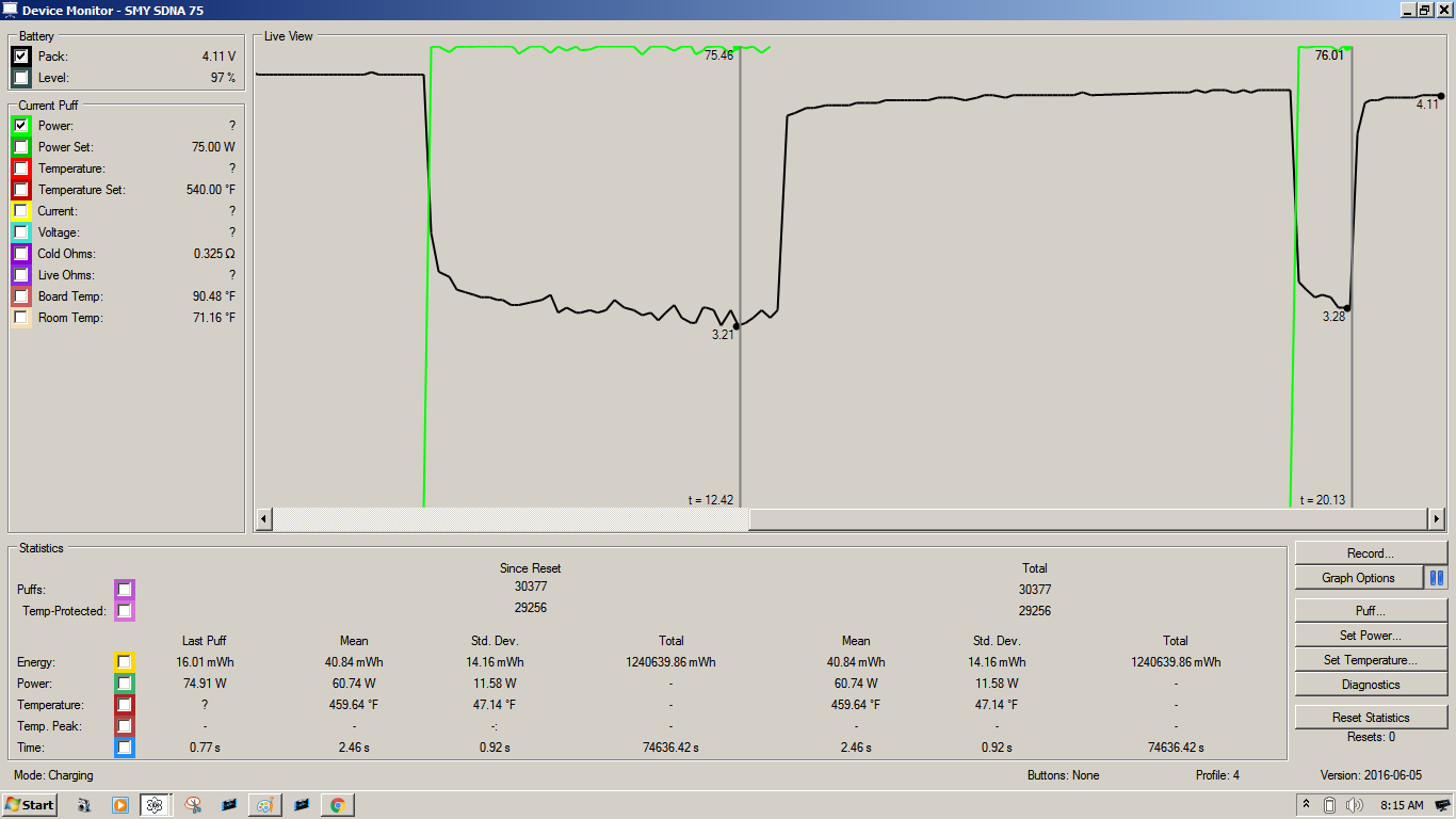

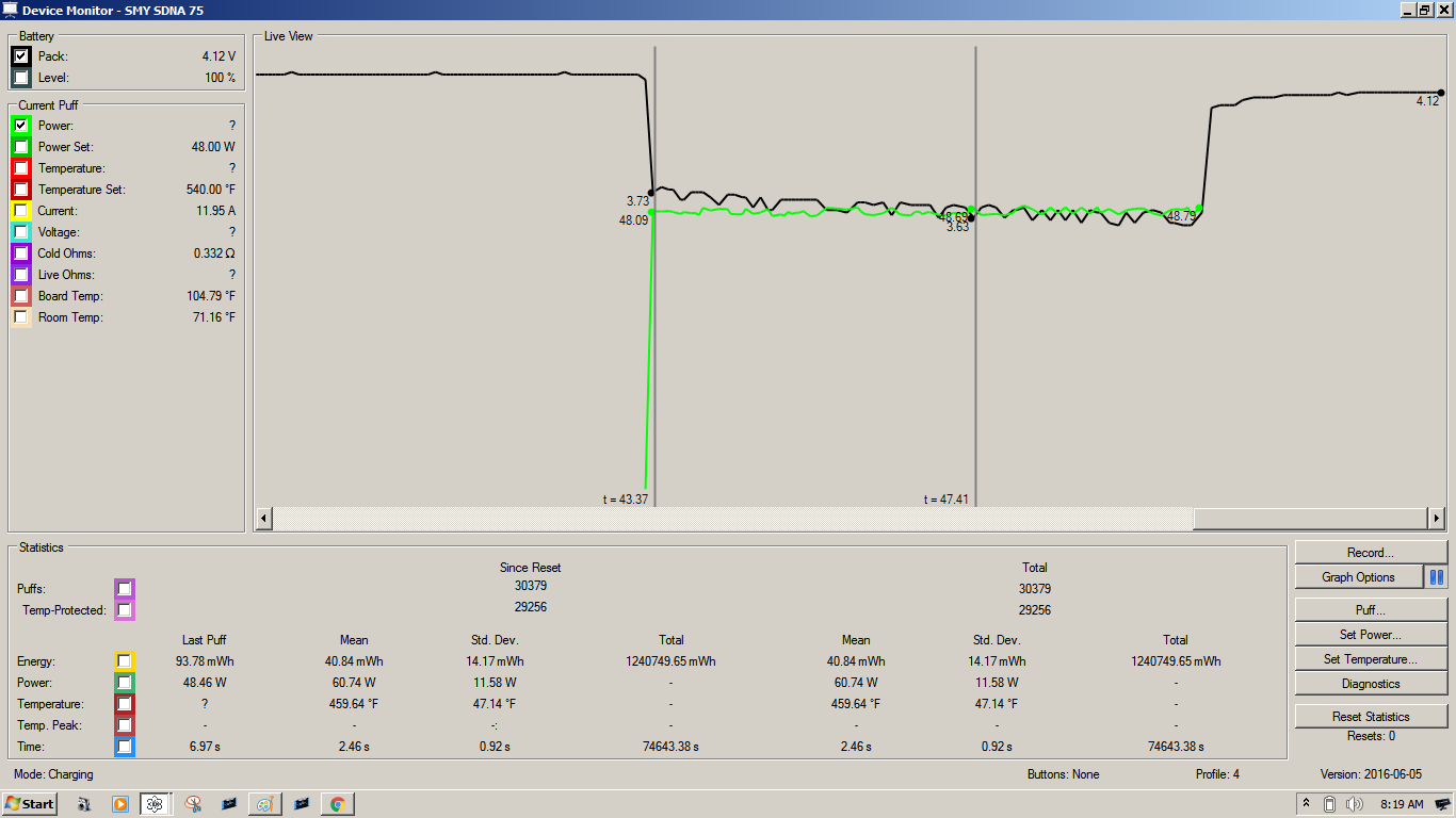

TBH, if you bought the cell from a reputable seller, the sag is consistent with my VTC5A cells. the DNA 75 is a power hungry board, as are most other single 18650 75w+ mods. you will see more sag due the fact you have only one cell to feed the DNA 75 board, where as 2-3 cells would spread the load across them. i'd say you're good to go. just a side note, you can check to see what your "cell soft cutoff" is set to. on my 18650 DNA 75 mods, i lower the value to 2.65v - 2.7v. what that does is slightly pushes back the "weak battery" bar flashing too early and eeks out a little extra cell life.
where did you buy the cells from? here's a few screenshots of one of my VTC5A's. one at 75w and the other at 48w, like yours. both with a .33 ohm load. what kind of sag do you see at 75w? what brand mod is this?

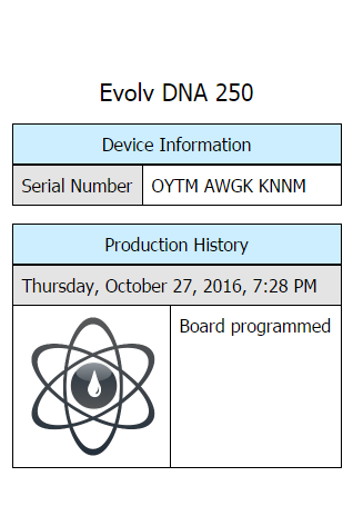

i'm guessing they just programmed a 250 with the 200's limits and sent it out to you. why? i don't know. okie dokie....take care Smeef!
welcome to forum Sh1buy4. you sure can switch a 167 back to a 250. you would need to rewire the balance tap connection for 3S operation and change a couple settings in EScribe.
ya your charging at .8xx amps from EScribe (would be 1a if you had a better USB cable. the USB current is limited if the USB voltage falls below 4.26v). so i bet it WILL charge at 2a if you get a good USB cable capable of passing 2a and a good 2a wall charger. what happens if you try and change your "kanthal power limit" to 250 and "upload" that to your mod? does the mod NOW go up to 250w? edit... and you would have to change your input amps to 28 for both fields. edit2... LOL your running 2 cell so 167 would be the max on kanthal power limit when in 2S mode.
strange, this is what i see when i plug in one of my 250's....... i would email evolv and ask them what's up with......."that". then post back here with the response you receive. as long as it's working for you and you're happy, that's what matters. just very curious as to why they sent you a "200 - ized" 250 board. maybe that's what they're sending out now for a 200 replacement, but that doesn't make a whole lot of sense me. i just don't know!
ya that's 100% a DNA 250 board. you see the component (inductor) on the front marked "4R7"? that is one of a few new components, only on the DNA 250, responsible for the 2a charging. if you go into EScribe, the USB current, on a DNA 250, should be limited to 1a and .5a for a DNA 200. do you see 1a? post a screenshot of device monitor with the USB voltage and current boxes ticked. also post a SS of your battery settings. this is interesting me.
that's a 250 board. at least the hardware layout is that of a DNA 250. post a pic of the front. that will tell me a lot more than just a pic of the back. that will also tell me what charging circuit it has. it can be possible you have the incorrect firmware on the board, your setting in EScribe are incorrect (kanthal limit, USB charge current limit) who knows. i don't see why evolv would send you a 250 limited to 200w, the 200 was not discontinued. although it is a direct drop in replacement for the 200, the 2a charging components make it necessary to modify the screen holder of many mass produced mods in order for a correct fit.
