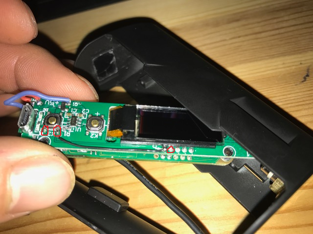

if you want to try something, solder that wire back where it was on the leg of the down button (make sure it's soldered on the SAME leg where it originally was!) and solder it to the 3rd pinout (circled in red). it was originally soldered in the wrong pinout . THIS FIX WILL ONLY WORK ASSUMING THE ACTUAL BUTTON WORKS (which i'm guessing it does since it functioned as a second up button because of the incorrect placement)! or wait and see what VD says. up to you. if i had the board in-hand i'd be able to fix it for you in 10-15 min. if the button is bad i have replacement SMD tact switches of that exact model. i mainly buy them for replacing vaporshark's faulty firing buttons.

the up and down button's neg pin-outs on the dna are tied directly together / to ground. looks like VD used a common ground path for both -/+, requiring the use of only 3 of the 4 available -/+ pin-outs. this is common practice to save material (wire) and time. short answer - the last up button pin-out not being soldered is OK and not needed. @flo_46 can you take a better, closer pic of VD's daughter board for me? i might be able to help you out..... also... can you check for continuity between these two point of the switch. should have continuity when button is pressed, no continuity when not pressed.
