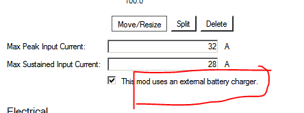

@sams......if you watch your battery line, in Escribe's device monitor, you should see the voltage "blip" (move slightly up, around 0.01v's) if you click between "enable and disable USB charging." this should tell you whether or not the charging IC is activating or not. or find and inline USB meter like i have. that's a sure fire way to tell if you're drawing any current. if you select this option this will also turn OFF you USB charging capabilities. -

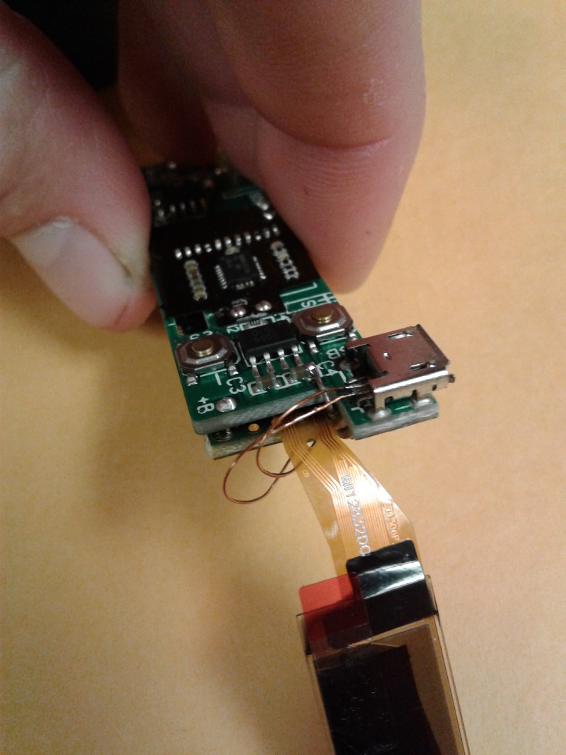

if i had to guess, i would say the hardest part of your build is going to be the soldering of tiny enamel coated wires to the USB data -/+ pinouts of the micro USB socket. hard but def doable. if you have any problems, just post em or shoot me a PM. Good Luck! -

one board has the RBP buzzer and one of the two charging IC's. the other board, on top of that board, has the second charging IC and the battery leads soldered to it. you would need to de-solder these two boards from each other and take a look at the USB pin out. you're going to have to do what i did when i decided to keep my VS DNA 40 daughter board. here's a photo of what i had to do to the USB (your USB socket will look similar to mine, our daughter boards are different but that is irrelevant). i will also personally help you through this if you decide to go this route. -

most likely one is the charging board, and one for the buzzer (does it have a RBP / buzzer?) and the other is the DNA 40 board. you'll have to most likely do what i did and solder small enamel coated wire directly to the USB pinouts. -

there are ways around having to use evolv's charging/data board. it's not an absolute must have. you can use the USB that is already inside the VS Vaporflask. the data pins might not be connected, but i guarantee you they are there. it all depends on your soldering skills and if you want to take the time to do it. -
