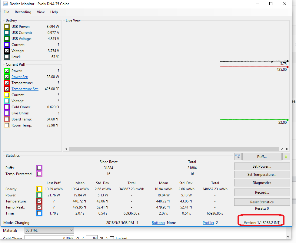

He does show an overshoot in the screenshot..... good catch..... good info you got from James.....

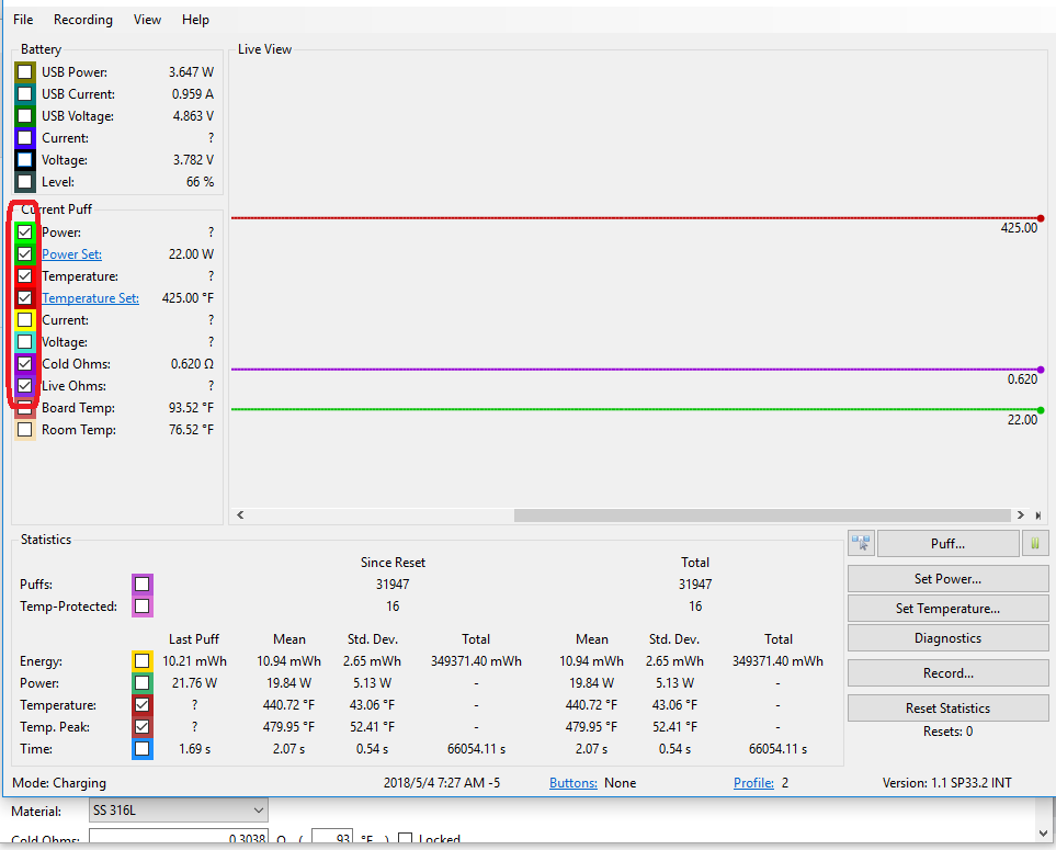

Unless I'm missing something it looks like you are reaching the set temp quickly and the power throttles down to maintain the set temp.... What happens when you set the power down to 60 watts?
Can you post a screenshot of Device Monitor while firing the cold coil which gives you the "throttled" message? Tick the following on the left side so it will show on the graph....
You might just contact the vendor you got it from and explain all the issues you have posted....
