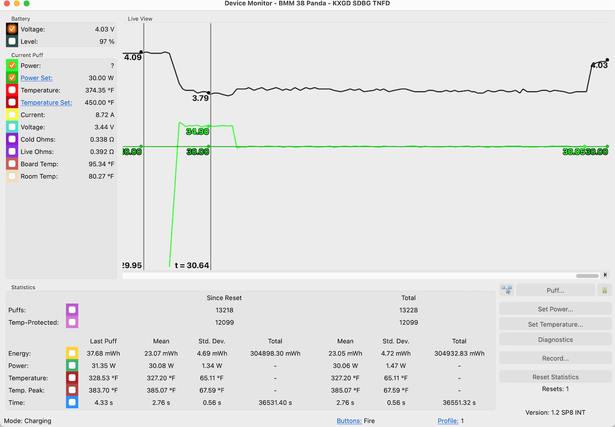

  1. Yes. Turn off boost/warmth on mod. Start 'Device Monitor', only enable 'power' 'power set', <- that shows what is set, take a puff, hit pause, hover mouse over the lines.
