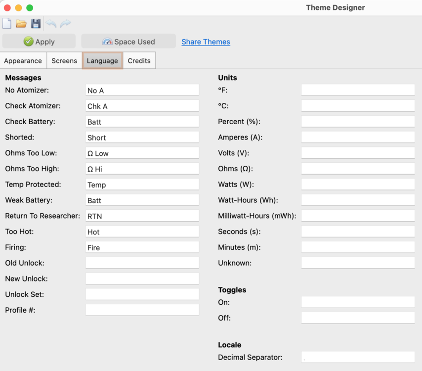

  11. That's in 'Theme Designer'. If you go to a field, on the RHS near the bottom you'll see the update while firing box to enable.

  18. Very odd. With your mod plugged, start escribe, under 'screens' check the 'brightness' value is high. Then start theme designer. Under 'appearance' 'fonts' check the 1st 2 fields have at least a value of 5. Failing that, reload Service Pack 75. Let me know how it goes.
