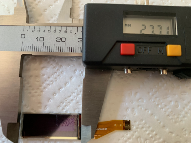

Triade DNA250C Screen Not Dislaying After 1 Year of Being Packed Away
Wayneo replied to ELiTE's topic in DNA 200 and 250
Screens that go bad usually develop a small white blob in the middle that grows to be a thumbprint size over time. In all my only 1 has ever done that. -
Even that's replaceable for like $12 USD -

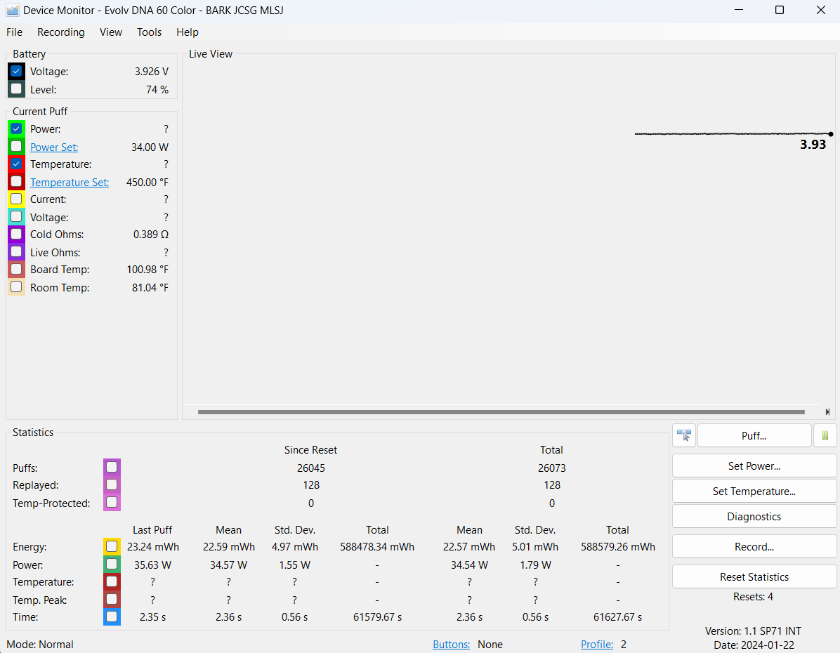

dna 75c weird cold resistance and overheating on the board
Wayneo replied to cloudzey's topic in DNA 75 Color and 100 Color
Yes, I understand the problem, but in my opinion you should focus on the board temp primarily. Afterwards we'll look at resistance. Plug in the 75C mod (nothing attached to the mod) How much does the board temp rise just sitting there and not being used? Note down temp after 2 minutes and 20 minutes after being plugged in. Leave mod and escribe running. Attach Bakx. How much does the board temp rise just sitting there and not being used? Note down temp now and 20 minutes after being plugged in. Report back those 4 temps like below , and battery description. 75C Nothing attached 2 minutes (temp here) 20 minutes (temp here) 75C bak attached 2 minutes (temp here) 20 minutes (temp here) -
What atty is that? Have you tried a different one on that mod? -
NO. What atomizer would that be? Can you do an escribe 'Device Monitor' screenshot while firing with only Power, Power Set, Cold Ohms, Live Ohms enabled -
@Jooki First I must say you've posted most excellent DM screenshots. It would be much easier for you to do some tests at 50 watts so @dwcraig1 doesn't waste his setup at 80 watts. Mooch hasn't updated his listing to show the P28B, but the P28A's were only really a 25A battery good for 75 watts.
