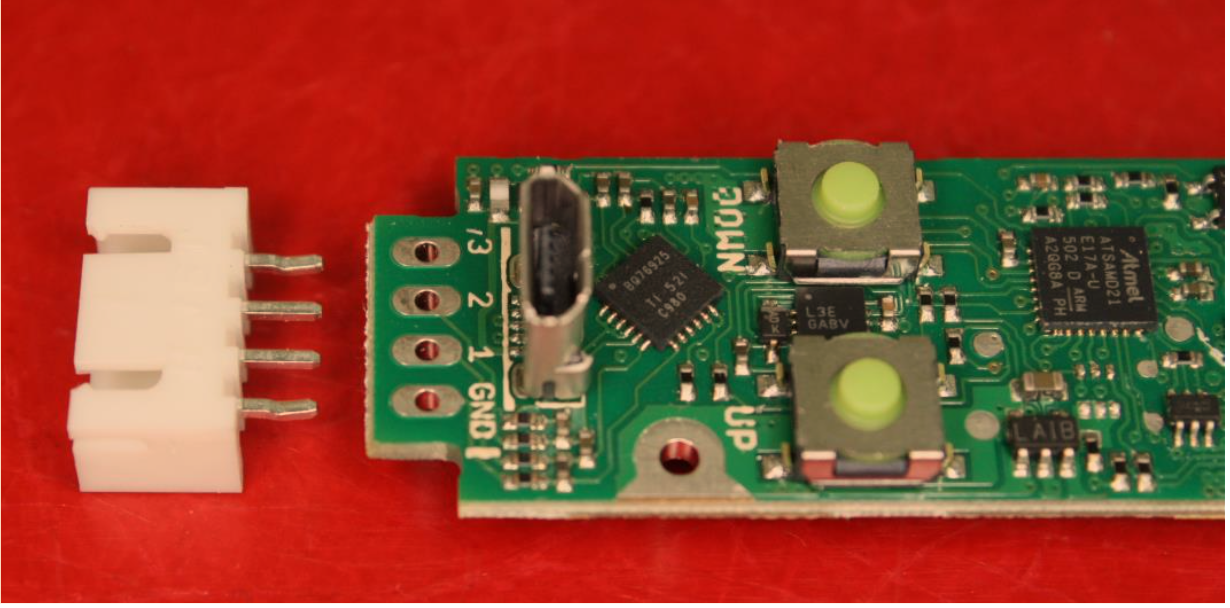

DNA60c wont connect to escribe ! Please Help
Wayneo replied to GrumpiTurnip's topic in Modders' Forum
IMHO you've gotta meter out all your connections. For the USB-C you know it has worked outside the box. I'd lift that off and see if it connects, then lift at the board end if it still didn't connect. What else could it be? Same thing for the battery. Using 1 battery, measure it externally then in each slot at all the connection points to the board. Then do the other battery slot. Same thing for the fire button and up/down. -

B- and G ground is cell 1 negative. Pin 1 is cell 1 positive and cell 2 negative. Yes, Pin 2 is cell 2 positive and needs to be bridged to 2-4 plus B+ like you have. But you need to clean it up. I also worry about all that exposed wire on the red. When you're done, use your multimeter and measure Ground + Pin1 (cell 1 voltage), then Pin1 + Pin2 (cell 2 voltage).
DO YOU SEE ME POST %'s IN MY POSTS? Now look at your cells. You really need to redo that soldering or clean it up so solder is only each pad from ground, pin 1, and pin2. I'll tell you from now, if I see a single % in anymore of your posts, someone else can help you.
