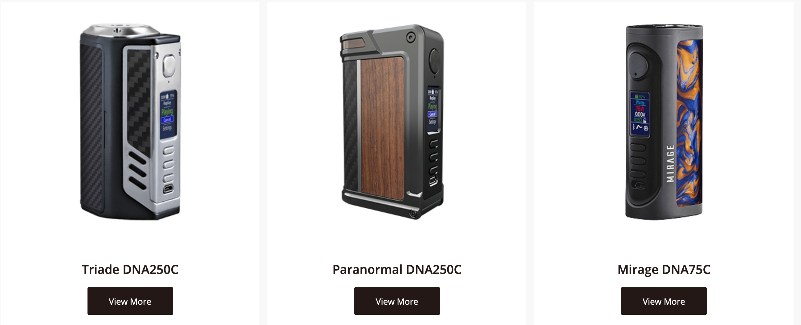

Wayneo Posted November 19, 2019 Report Posted November 19, 2019 15 minutes ago, Lanzarotechris said: If you go to the Lost Vape webpage and try to look for any DNA X Mod (and I mean REAL Mods, with removable batteries and DIY Coils, like DNA75, 250...) then you will see where the focus is. Just went. Box Mods, 1st on the left. 1 click and .............
blueridgedog Posted November 20, 2019 Report Posted November 20, 2019 Where are you seeing those. I can't find any of them on the site. Can you post a link?
blueridgedog Posted November 20, 2019 Report Posted November 20, 2019 ...also when I search for Mirage on their site I get zip. The mirage is my go to mod, but now that ebay is dead on vape, I can't even find used ones.

James Posted November 20, 2019 Author Report Posted November 20, 2019 @blueridgedog: https://www.lvevapor.com/box-mod/ 1
blueridgedog Posted November 20, 2019 Report Posted November 20, 2019 8 hours ago, James said: @blueridgedog: https://www.lvevapor.com/box-mod/ So they are back in business! Good. Can't click the Mirage link yet, but great that they have resolved their issues.
Lanzarotechris Posted November 21, 2019 Report Posted November 21, 2019 @wayneo When I say lost vape website I talk (of course) about https://lostvape.com/ Not some cryptic b-side noone else know about... sorry...

Wayneo Posted November 21, 2019 Report Posted November 21, 2019 4 hours ago, Lanzarotechris said: Not some cryptic b-side noone else know about... sorry... Hey Chris, couple things. I see I had posted that link twice before, first time 9 months ago ............ but not this time. I posted the pics and James posted the link It really does sound like a cryptic link, but hey, we can't force them to change their ways. AND I FULLY AGREE WITH YOU. No need to be sorry pal, have a good one!
