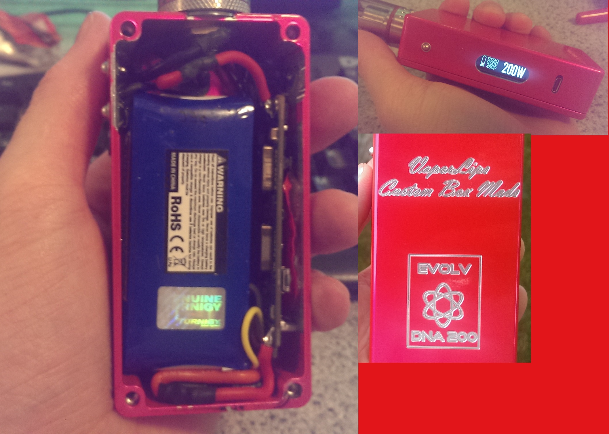

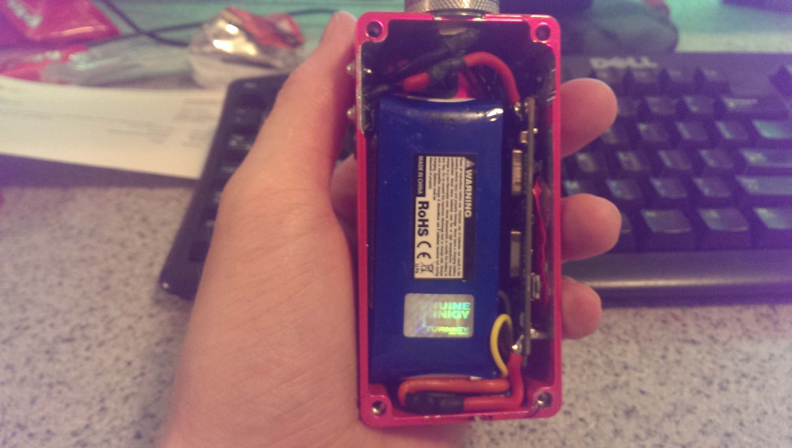

vaporlips Posted July 14, 2015 Author Report Share Posted July 14, 2015 Here's the fit of the Turnigy 30C 1000mah in one of the "CNC" 1590G. This is my "thrown together quickly for testing" device. It all fits as long as you use C&K Tactiles for the switches. Well, you could always use the push rod setup for switches too. Link to comment Share on other sites More sharing options...
Wick Posted July 14, 2015 Report Share Posted July 14, 2015 vaporlips said:Here's the fit of the Turnigy 30C 1000mah in one of the "CNC" 1590G. This is my "thrown together quickly for testing" device. It all fits as long as you use C&K Tactiles for the switches. Well, you could always use the push rod setup for switches too. Beats mine, I'm still running the "Invisicase" I built on day one...... Good news is I'm yet to find a battery that isn't a perfect fit!! Link to comment Share on other sites More sharing options...
