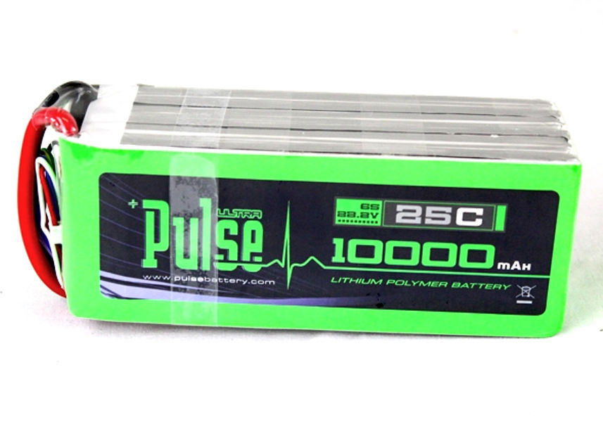

Matt_302 said:
Quick question would you guys think that this lipo pack would fit in the beta enclosure or steer me into the right direction for a good mah rating lipo to use in the beta enclosure I have a buddy 3d printing me the enclosure and just wanna make sure I'll have enough room.
That's lipo too big to into beta enclosure unless you make some adjustment. Beta enclosure 94mm in heigh and that 5000mah is 150mm.
Link to comment

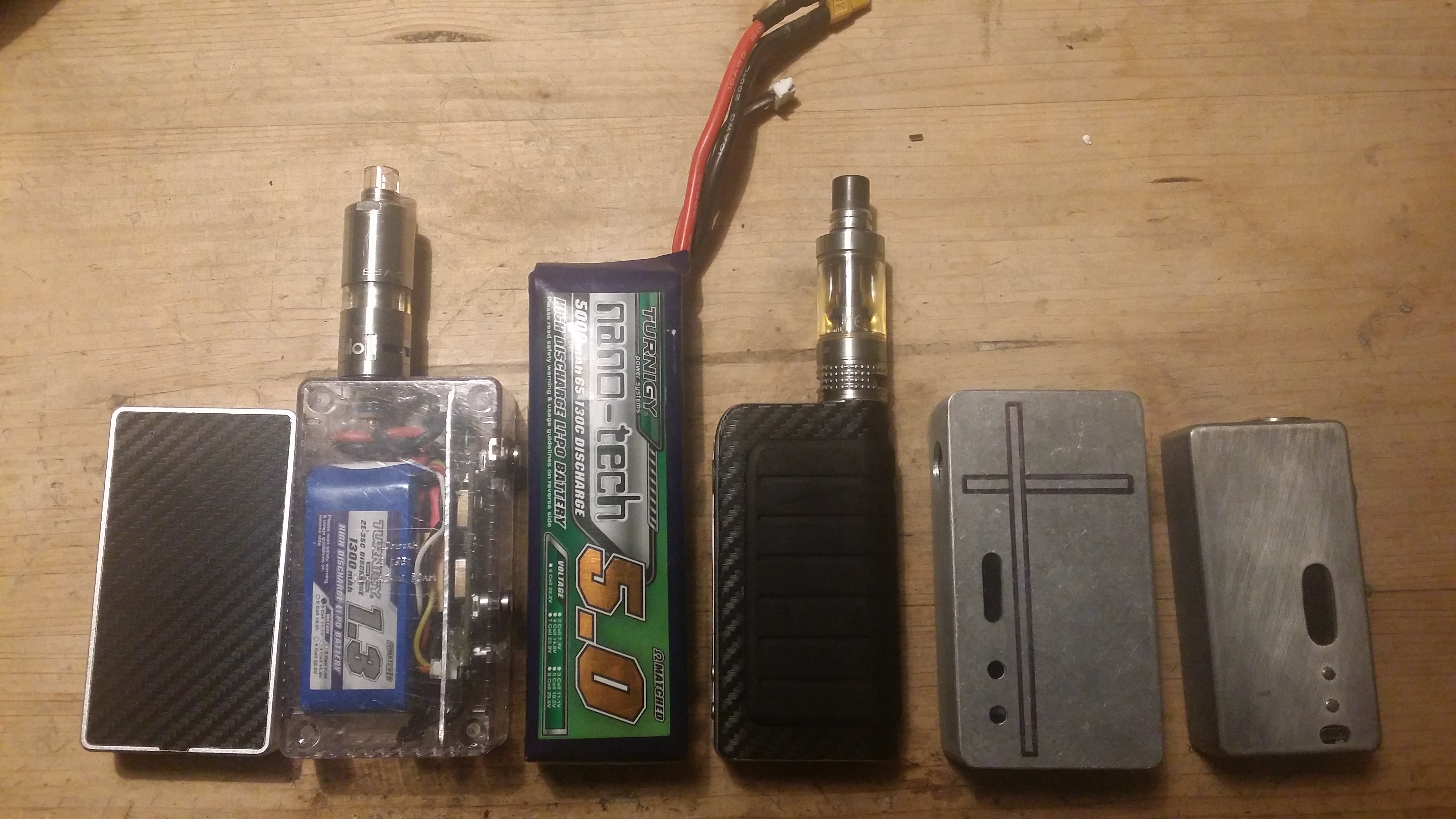

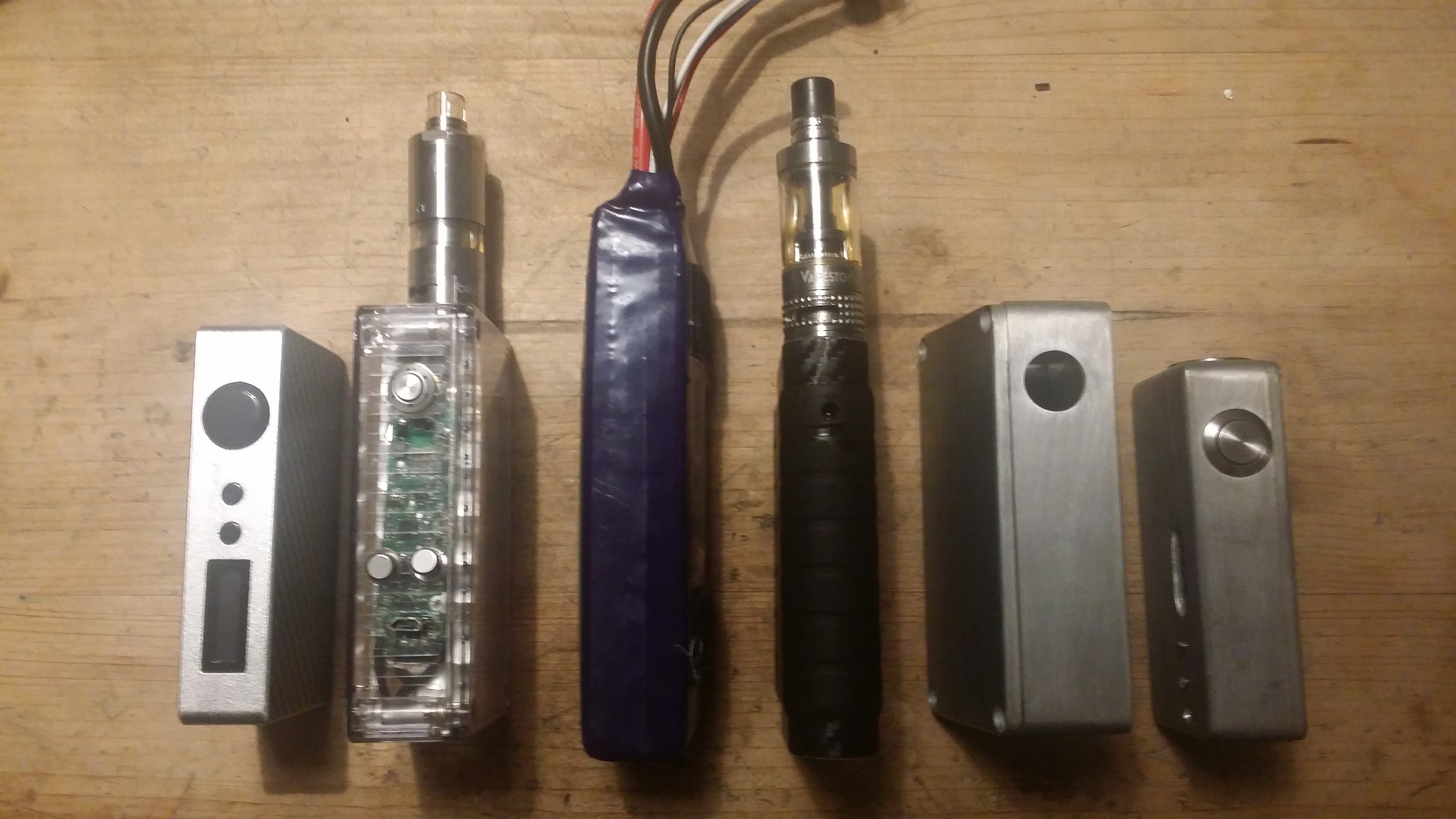

Share on other sites
I was assuming that the question about the 5000mah battery was not serious...but in case it was...here are a couple pics of that battery (from one of my multirotors)...lined up with some mods... From left to right: Seigeli 150w; Ham 1591; battery; ipv4; and Hammond 1590b; Hammond 1590g. So to answer the question: since the beta box is smaller than all of these - no way. Think they are using an 850-900 mah batt.
Link to comment
