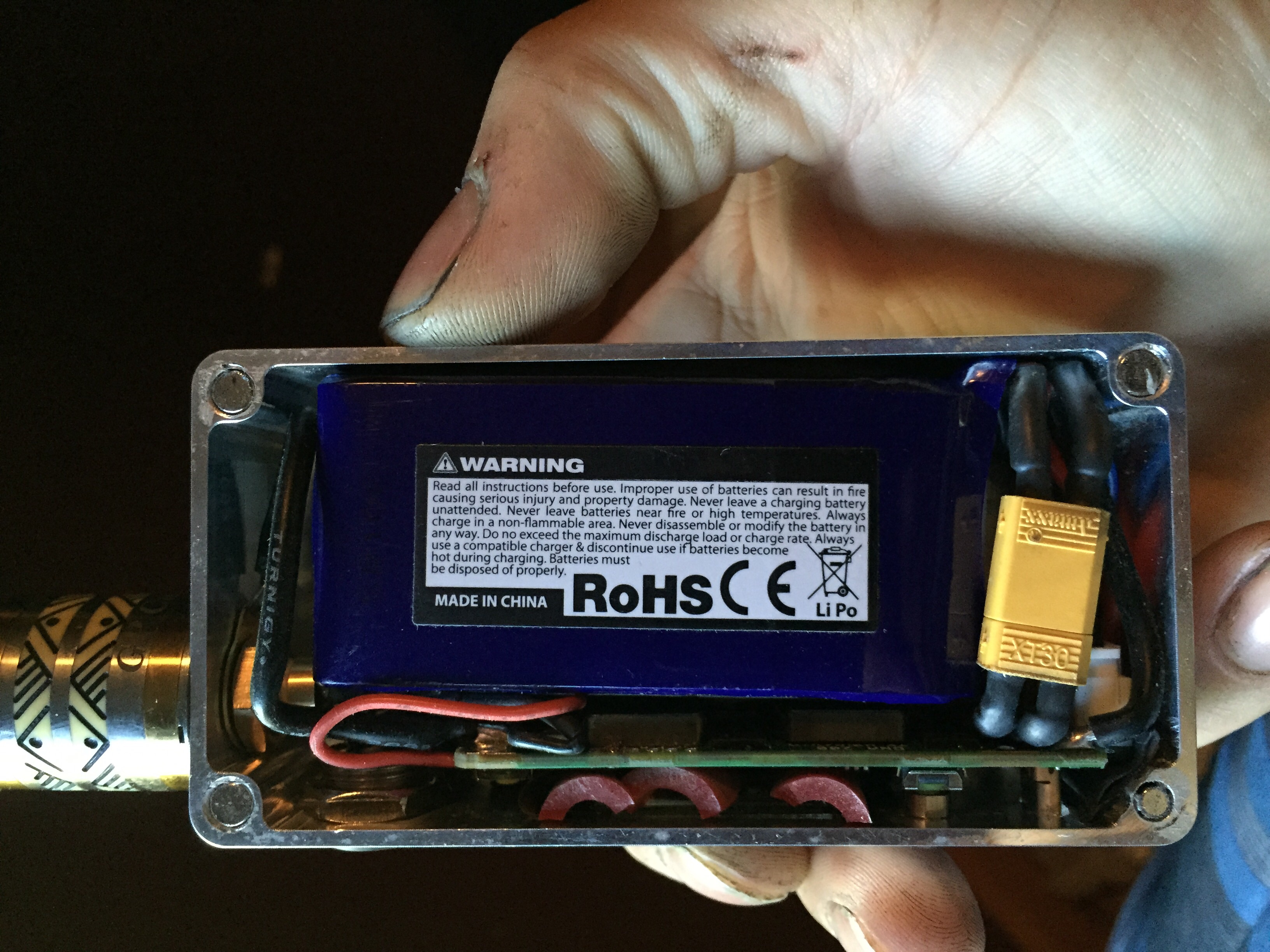

redwolfe90 Posted July 31, 2015 Report Posted July 31, 2015 My own 3d printed design, next to a Hana 200. Measures 105mm x 50 x 24, just 5mm taller than a 1590G box. Would really love to get this made in aluminum. Got a 1200mah lipo pack inside, one could put a smaller cell inside to make room for connectors (XT30, etc) for easy battery swapping. As it is now, there's no wiggle room at all.

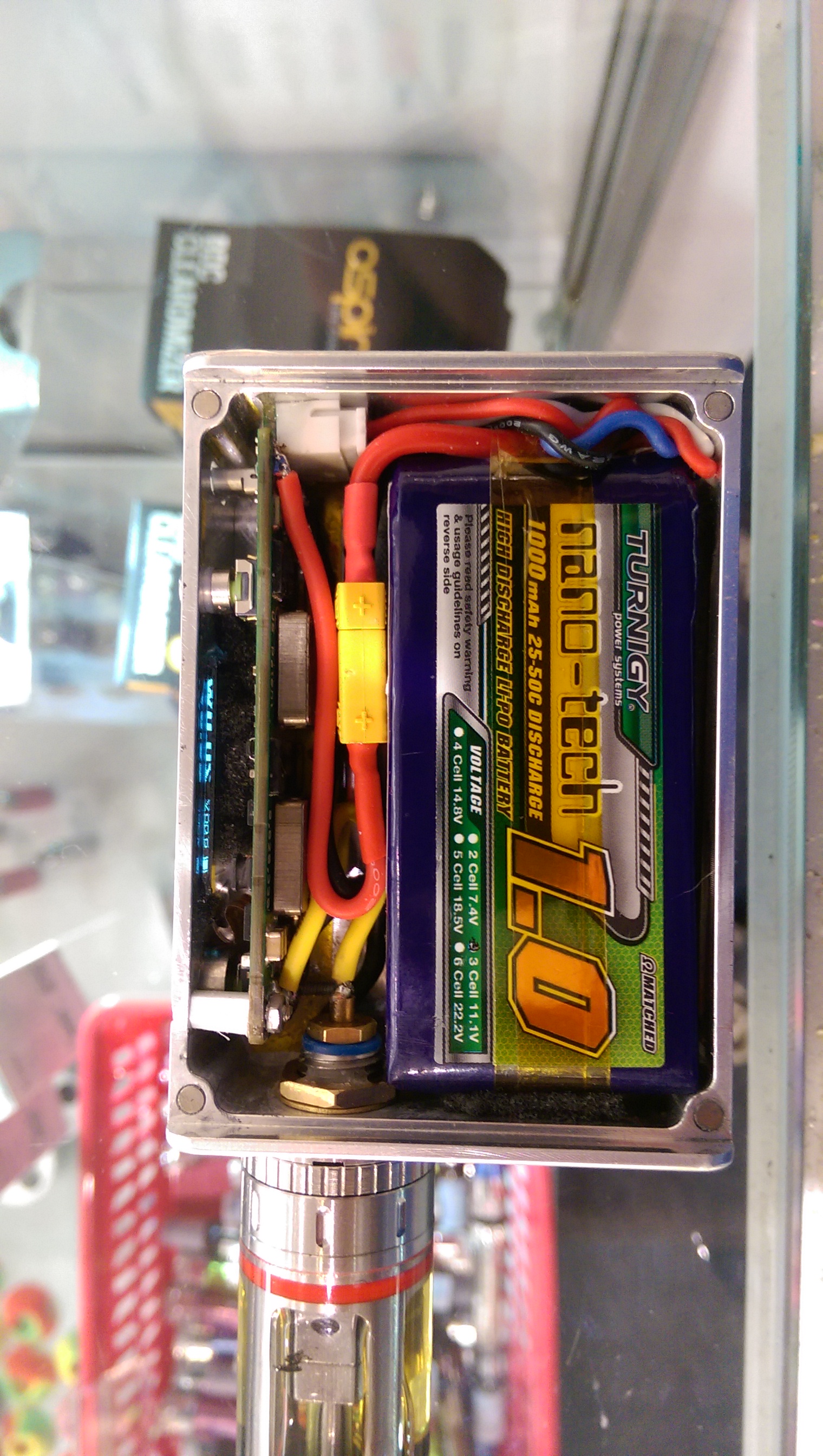

David247 Posted July 31, 2015 Report Posted July 31, 2015 Here is mine I take I didn't need the ground on the 510 ? Regards David

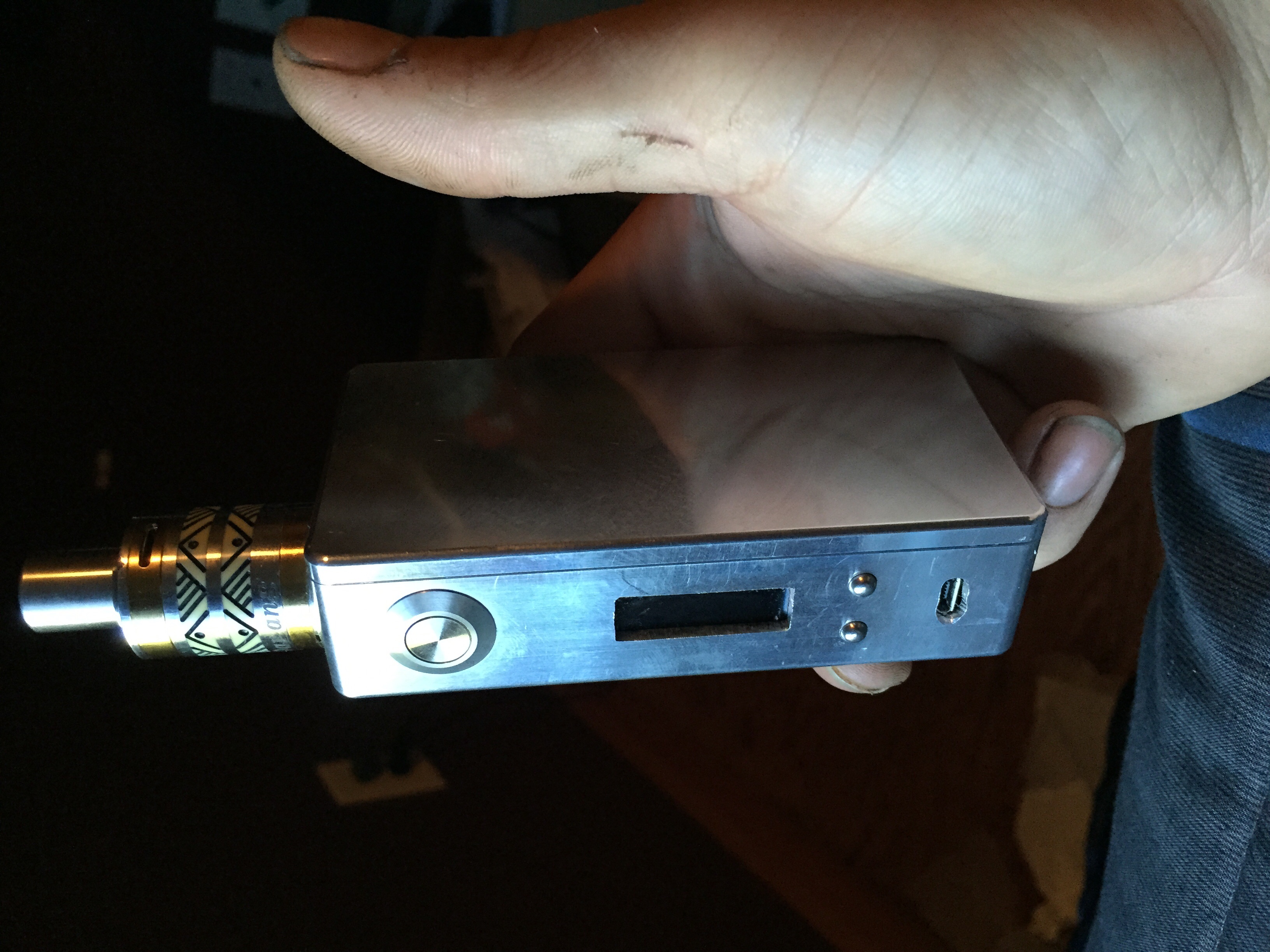

mandro Posted July 31, 2015 Report Posted July 31, 2015 In my haste to finish, i cut the display cut-out too small on my DNA200.The board as been performing so well, I thought that the display deserved to be seen so I re cut the aperture lol

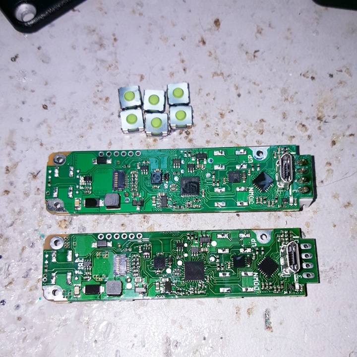

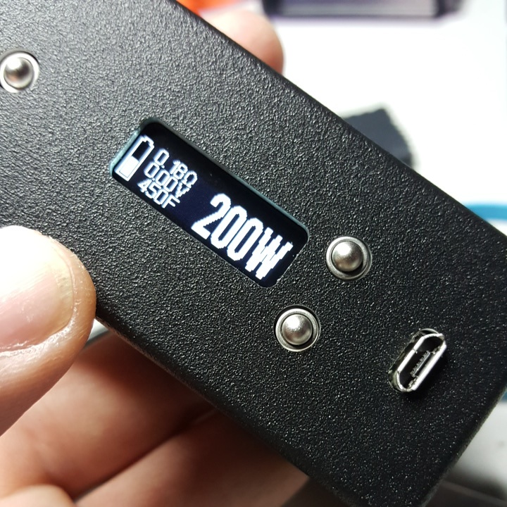

xevape Posted August 1, 2015 Report Posted August 1, 2015 #2 in a 1590A Videohttps://instagram.com/p/50iEj3AWIS/?taken-by=xevape
Always_Jonezen Posted August 1, 2015 Report Posted August 1, 2015 xevape said:#2 in a 1590A Videohttps://instagram.com/p/50iEj3AWIS/?taken-by=xevape Looks damn good a lot of compact power. The only thing I see wrong is the Usb port is sticking up out of the case. Other than that I love it.
xevape Posted August 1, 2015 Report Posted August 1, 2015 Always_Jonezen said:[QUOTE=xevape]#2 in a 1590A Videohttps://instagram.com/p/50iEj3AWIS/?taken-by=xevape Looks damn good a lot of compact power. The only thing I see wrong is the Usb port is sticking up out of the case. Other than that I love it.[/QUOTE]Working out the USB Port issue on #3. I'm going to not cut the legs of the tact switchs so short as to raise them ever so slightly allowing the USB to rest even.
VapingBad Posted August 1, 2015 Report Posted August 1, 2015 You could make a shim for under the switches xevape, EG n layers of kapton tape would work well and you can get the height very exact. If you did don't do one at a time, layer lengths of tape then cut and fit to the back of the switch before soldering.
xevape Posted August 1, 2015 Report Posted August 1, 2015 VapingBad said:You could make a shim for under the switches xevape, EG n layers of kapton tape would work well and you can get the height very exact. If you did don't do one at a time, layer lengths of tape then cut and fit to the back of the switch before soldering.Trial and error my friend. Great thing about these is they are SUPER easy to break down and rebuild. The switches hold the dna200 in place, then a layer of heat shrink then the battery.
VapingBad Posted August 1, 2015 Report Posted August 1, 2015 I have done a few mods using the KSJs and usually have the up/down counter sunk so I don't need atty lock with the fire standing proud, but interference fit will loosen with use in aluminium so I always add some epoxy, polymorph or sugru to stabilise the switches, but then they are not so easy to rebuild. More to the point that is that if you are making them in quantity you want easy repeatability and doing say 9 layers of tape is easier and more accurate than trying to bend and cut 4 legs without a jig.ETA it's late here and I think that reads more negative that I meant, well don't mean to be negative at all but I am too tired to fix it and dyslexic so it's too easy for me to write what I don't mean.

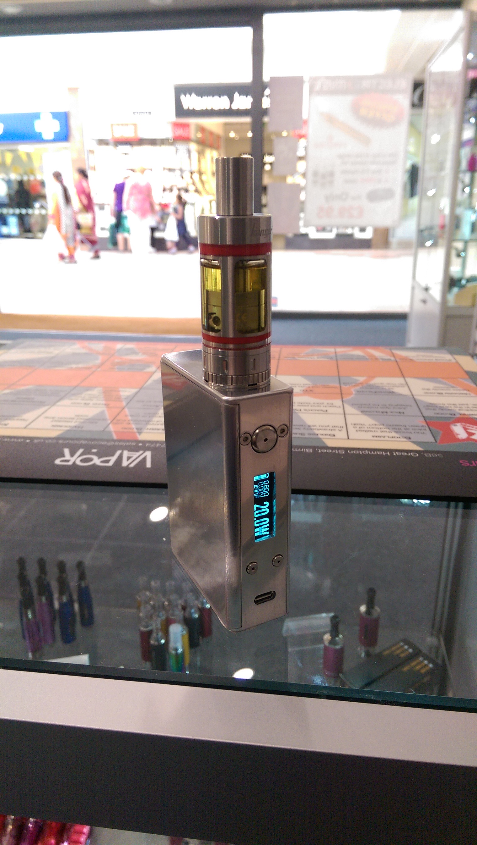

Bob Posted August 1, 2015 Report Posted August 1, 2015 N1 enclosure/2200 mah pack/Mamu face plate. Finished yesterday. I'm honestly used to dripping w/ a lot more powder w/ the same 3s pack in my PWM box. I really want to like this board. I do like the screen and safety features built in for the lipo. If there was a firmware upgrade for 50-100 more wattts (250-300watts total) I would be stoked. lol
Cotay Posted August 1, 2015 Report Posted August 1, 2015 Here is what I'm building tomorrow! Happy weekend to me!
John Posted August 1, 2015 Report Posted August 1, 2015 Bob you are officially the first to say they need more power. Do you have a measured mod resistance? Getting that right can get you a bit more oomph out of the board. What is your coil resistance, and are you running temperature protected?
