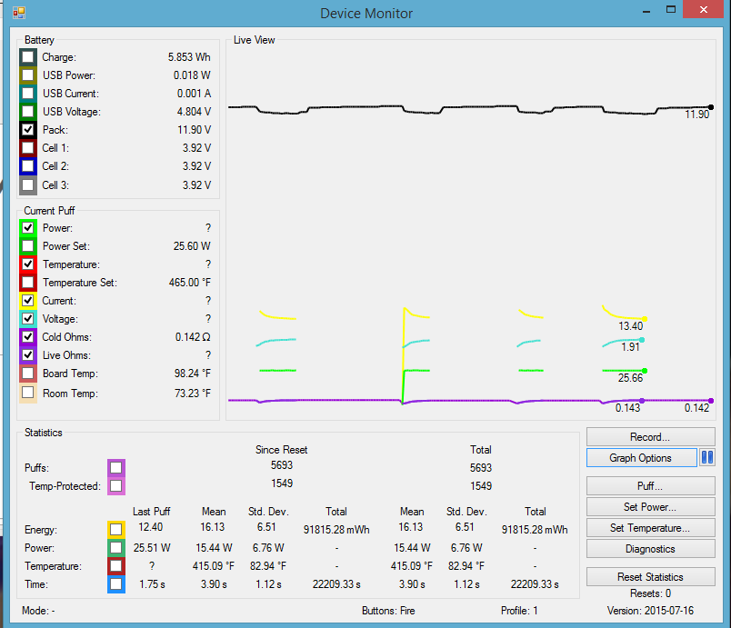

blueridgedog Posted August 25, 2015 Report Posted August 25, 2015 I hate to add that I was using a Hana cable for my updates! The chip appears salvageable but as laadam pointed out, there is an issue with virtualbox connectivity that I need to figure out. It is fine for configuration, but it appears to drop the USB connection periodically (using USB3 ports). I am going to get it some more, but you can actually see it in device monitor...a periodic drop. My problem I think is that this happened in the flash process.
KTMRider Posted August 25, 2015 Report Posted August 25, 2015 blueridgedog said:I hate to add that I was using a Hana cable for my updates! The chip appears salvageable but as laadam pointed out, there is an issue with virtualbox connectivity that I need to figure out. It is fine for configuration, but it appears to drop the USB connection periodically (using USB3 ports). I am going to get it some more, but you can actually see it in device monitor...a periodic drop. My problem I think is that this happened in the flash process.That might be the source of all your ills. I tested both Hana cables I have and both are crap. I use Blackberry, LG, Samsung and Anker USB cables for both charging and data transfers.
