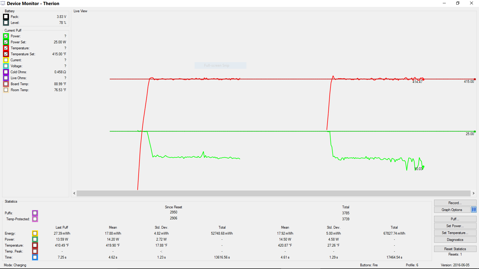

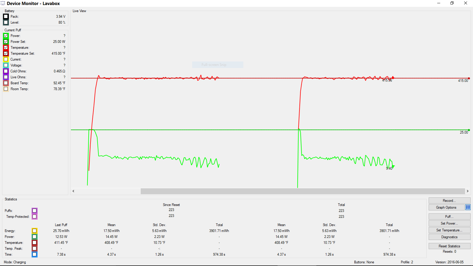

2legsshrt Posted September 14, 2016 Report Posted September 14, 2016 You can see where I was running out of breath at the end of the puff but they look pretty good don't they?
2legsshrt Posted September 14, 2016 Report Posted September 14, 2016 I also notice that the room temp is off don't know if that makes any diff it's about 71-72 in here.
retird Posted September 14, 2016 Report Posted September 14, 2016 hum..... both are regulating very good with the temp of the Therion not fluctuating as much as the Lavabox... , cold ohm's slightly different.... I guess the vape is great with both. So you can watch the Lavabox display the whole time you vape and the temp doesn't flash even once? If I recall the later firmware versions tightened the temp regulation so the temp doesn't swing as much above and below the set temp and what I don't know is how far above the temp setting must the temp reach in order to trigger the temp protect flash.... Maybe others can shed some more light on this but adjusting the temp and wattage a bit on the Lavabox may cause the flash to trigger but it is clear it is reaching and maintaining the set temp. So with the Lavabox can you get the flash if you chain vape it? In other words the flash can occur.
2legsshrt Posted September 14, 2016 Report Posted September 14, 2016 It doesn't even flash when I just hold the fire button without vaping it it just stays right on between 413-416 never flashes once.

retird Posted September 14, 2016 Report Posted September 14, 2016 2legsshrt said:You can see where I was running out of breath at the end of the puff but they look pretty good don't they?Yep they look very good. I too use SS316 but it is premade "Notch coils"... I don't build coils at all... I like it simple...You are really getting the hang of DNA's and EScribe, in a short period of time....
IMoL Posted September 14, 2016 Report Posted September 14, 2016 2legsshrt said:It doesn't even flash when I just hold the fire button without vaping it it just stays right on between 413-416 never flashes once.Is the "Temp Protect Message" turned off on the Lavabox (theme tab)?:I do this with all my DNAs.
retird Posted September 14, 2016 Report Posted September 14, 2016 Yep, temp protect message turned off is a possibility. Won't have thought it would come from Lavabox set that way.....
2legsshrt Posted September 14, 2016 Report Posted September 14, 2016 Exactly right. I got to thinking about it and thats what it was it was turned off. Now it shows just like the others. I thought I has some super model for a minute. I kind of like it turned off.
retird Posted September 14, 2016 Report Posted September 14, 2016 2legsshrt said:Exactly right. I got to thinking about it and thats what it was it was turned off. Now it shows just like the others. I thought I has some super model for a minute. I kind of like it turned off.Good to see this got sorted out.... enjoy....
