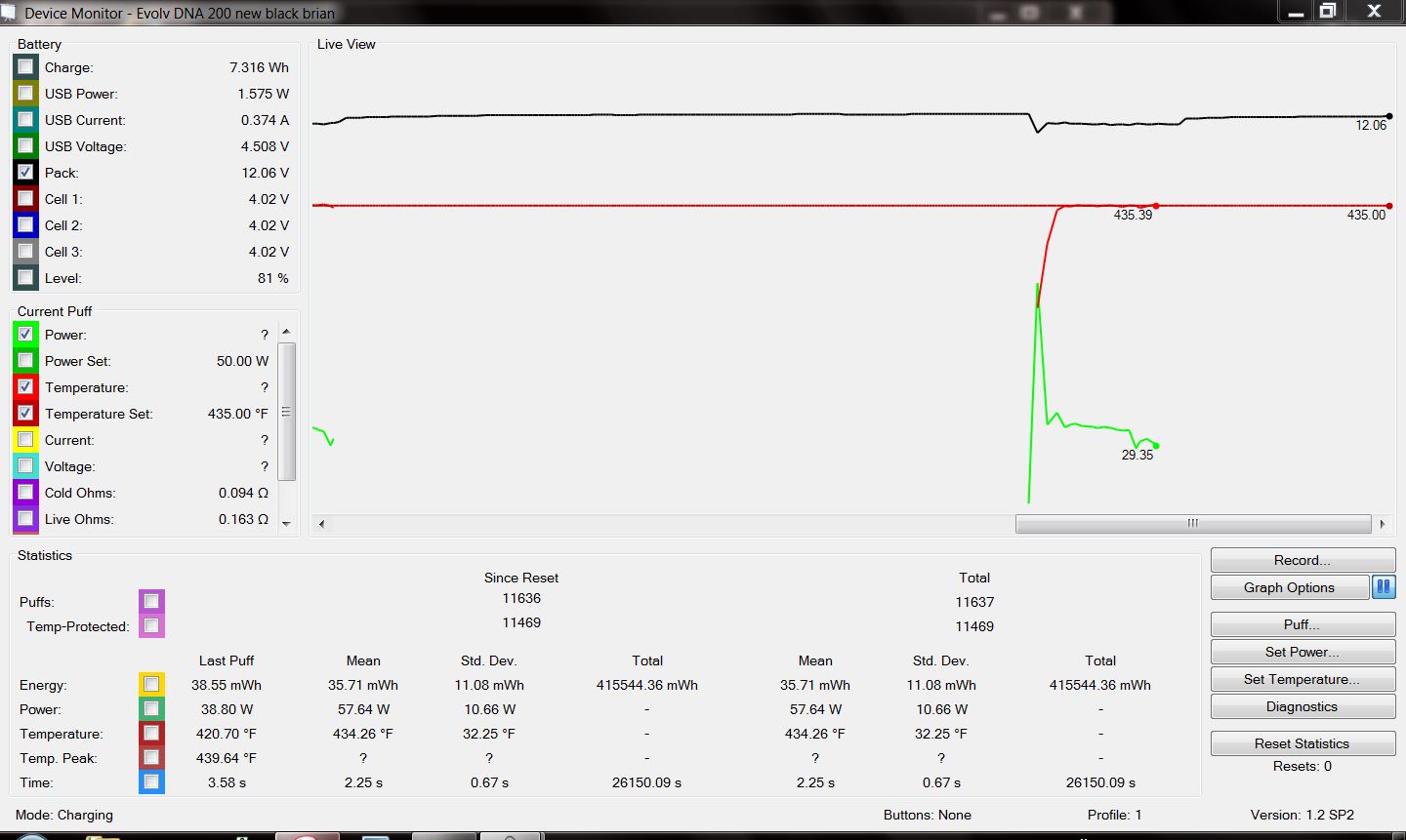

very nice. thats a significant improvement.
after installing the update i fired up the device monitor n was pleased with how much smoother my 316l was, but i was getting what i thought was a twinge of dry-ish hit as i was "testing."  i thought "thats weird, it looks very much more stable on the graph??"
.....my tank had runith dry. : )
feeling like maybe trying out some ss316l fused claptons again after giving up on a set of 26/38's i put in when i first got the dna200. the increased stability on these simple spaced coils is promising.

update sp3 loaded and running the only comment i can say is that while using device monitor to change a setting say temapture in this case i still have to click ok rather then enter. but i do love the indepente use
