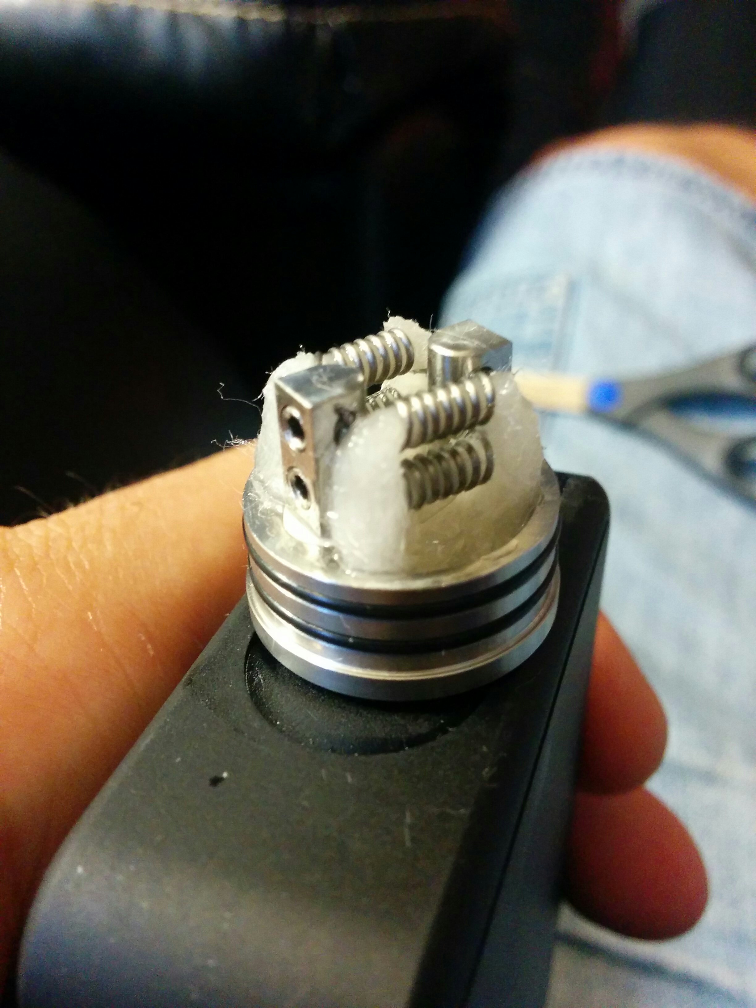

Ken Nutter Posted July 25, 2015 Report Share Posted July 25, 2015 I've had great success with Titanium coils... Best build to DATE hands down... A quad TI.. 7wraps around a 2mm post. Reads in @ 0.05ohms. Thing is just amazing its the longest I've ever kept the same build in a RDA without getting bored of it. I changed it out to run a dual TI build to save on juice but think I'm going back to my quad coil later today beats all my NI builds hands down Link to comment Share on other sites More sharing options...

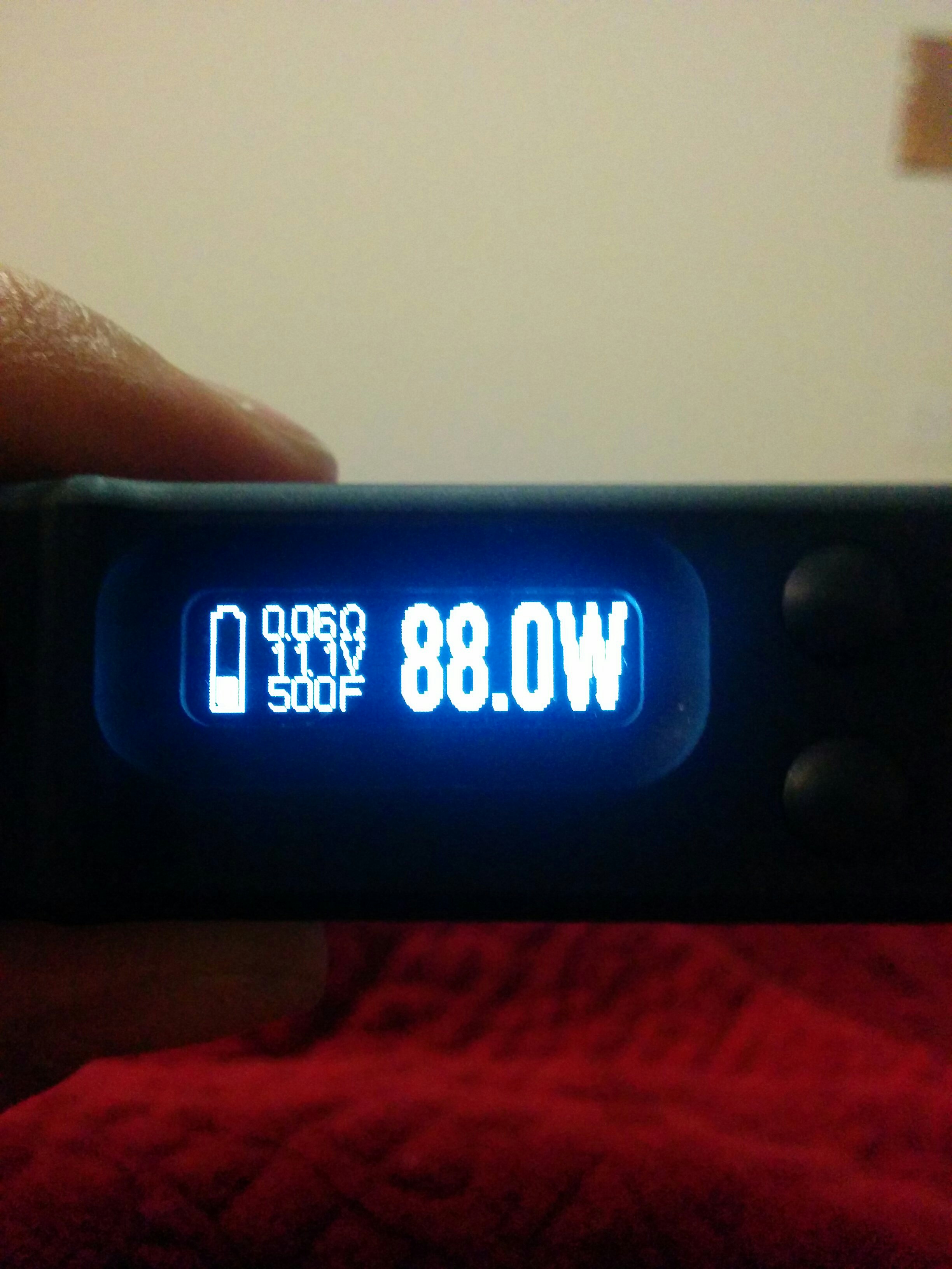

G_livin Posted August 14, 2015 Report Share Posted August 14, 2015 I'm using a dual coil 8/9 wrap at a 3 mm. Ohms out to .16 with 24 guage at 88 watts with temp really decent clouds compared with kanthal without temp control Link to comment Share on other sites More sharing options...
