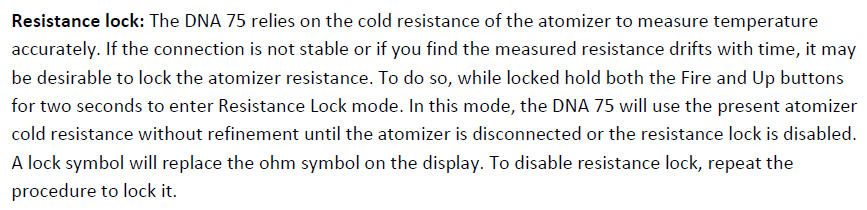

  14. I suppose I am the "moron" who kept insisting not to lock res, misquote, locking res stops DNAs working as designed, will not be as accurate as not locking and should not be done by default. Personally I think you have a build, connection or mismatched wire profile issue. Please stop posting extensively about other devices, this forum is for people to discuss DNAs there are plenty of places on the internet to compare products. I am not saying never mention other devices, but it is too likely to start arguments and attract negative comment about those devices and this forum is not here to criticise the rest of the market.

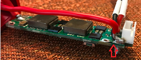

  21. You have lifted the battery negative pad, you should never put the strain of bending wires on solder pads, especially these very thick wires. Always bend the wire to it's final shape before soldering, you can get more flexible wire with finer strands, but if the solder wicks up the wire it will still become stiff. Also holding the heat on for too long can cause the pads glue to melt. You may get away with connecting to a mounting point, but you may have damaged some of the nearby tracks.
