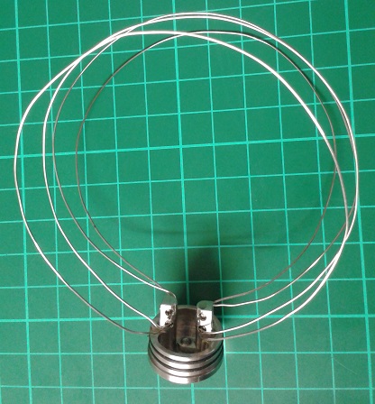

Have EScribe Options - User Interface set to Manufacture. Just get a dripper deck and make a coil that will not get too hot, I make 4 parallel loops of 0.5 mm Kanthal around the size of a tennis ball that is good for 50 W test, you can go larger, but I wouldn't go much smaller. Put this in your mod with fully charged batteries, make sure it is standing up somewhere where it will not get knocked and the coils are not near anything that could get damaged by heat, then start the test the power level you like to vape at. You can record it to a csv file and then look at the detail in Device Monitor later, but this is not necessary. When the test finishes choose accept result, then the Save CSV button the save the battery profile.
