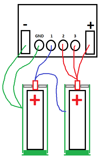

  4. You can just jump terminals 2 & 3 you don't have to have 2 wires, hope this makes sense.
  5. Great, I'll have a quick bash in paint, it won't be pretty I'm afraid, but if anyone has one please post it.
  6. Are the tubes isolated (electrically) from the case? I have not seen a diagram as it all depends how you are fitting the tubes in the case, because the cells are in series you can't have both tubes grounded to the case.

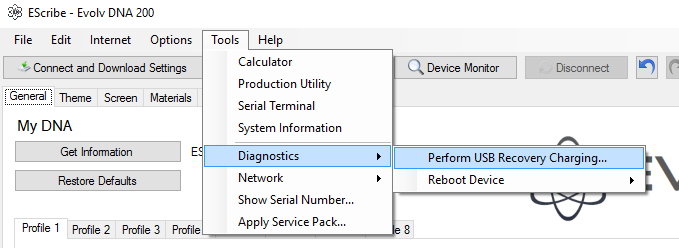

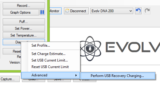

  21. That is not USB Revovery Charging, you don't need to change the thing you are looking at. Go here or here on older versions of EScribe < V1.2, same thing
  22. I replied about charging in another thread. To get to the battery settings you need to go to EScribe - Options - User Interface and choose Advanced or Manufacture to enable the Mod tab.
  23. Are any of the cells below 2.5 V, you can check in EScribe - Device Monitor, if so you either need to return it to the vendor as they should not be sold in that condition and if they are very low for a long time it ages the battery and cane even stop them working altogether or you can try EScribe - Tools - USB Recovery Charge.
