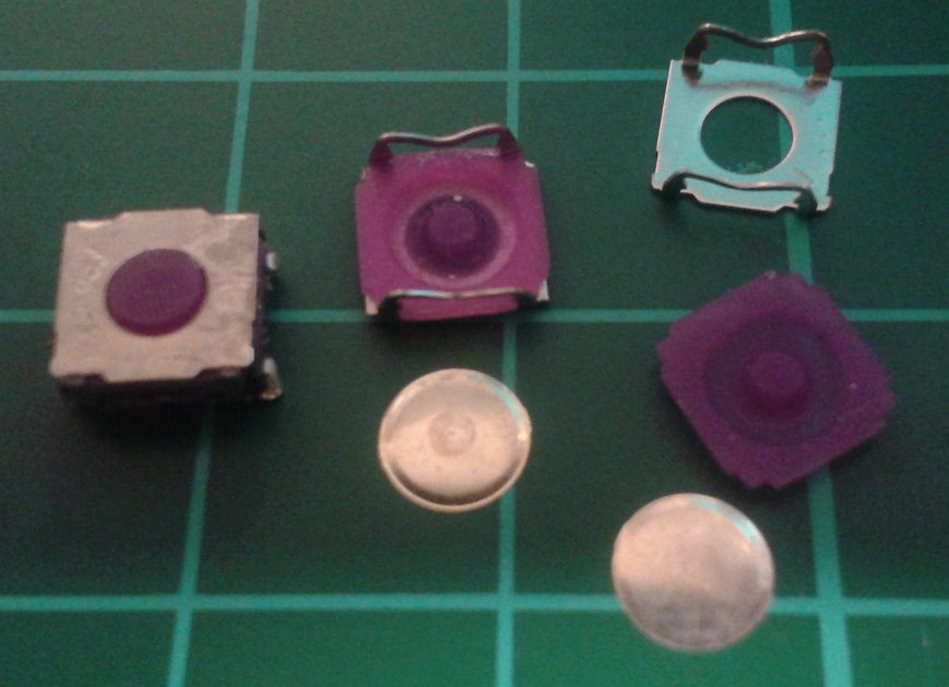

To see what I mean, the metal disc and contacts can get dirty, check which way up the disc goes so you put it back correctly.

I was going to suggest just that: taking the bottom cover off and giving it a clean in IPA.
