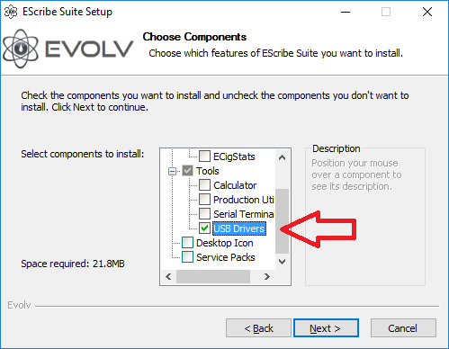

  18. The drivers are on the PC, you can run the installer again and just check drivers in the options if you want to reinstall them.
