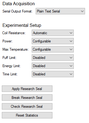

I have never seen that, but would check the research tab in escribe, specifically that the puff, energy and time limits are set to disabled. Here is what the defaults look like. -

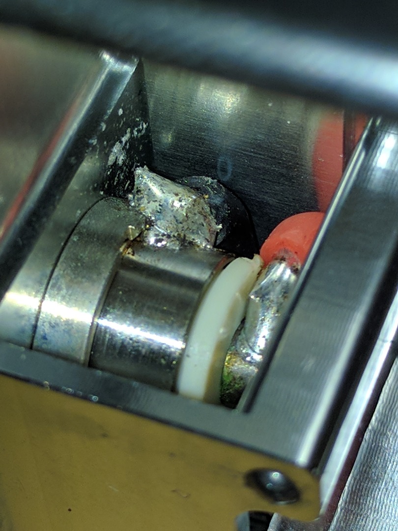

That sounds more like an issue with the 510 or atty, have you connect it to EScribe to get a live resistance reading when it does it? I don't think the atty analyser issue and it saying shorted are connected. I have read about people who have found tiny bits of machine swarf in their 510s causing strange problems, that or damaged insulator or damage wiring are the most likely thing I can think of ATM. -

If it is just that the mod res reading is ? and you can get a stable reading with the old fw then I would just use that value with the new fw, I do in fact with no issues. It is only an extra feature and it reading ? will not cause issues with anything other that trying to read the mod res. It is a very different scenario from it tracking the resistance of an atomiser, you would never try and vape a coil that was below 0.01 ohm.
