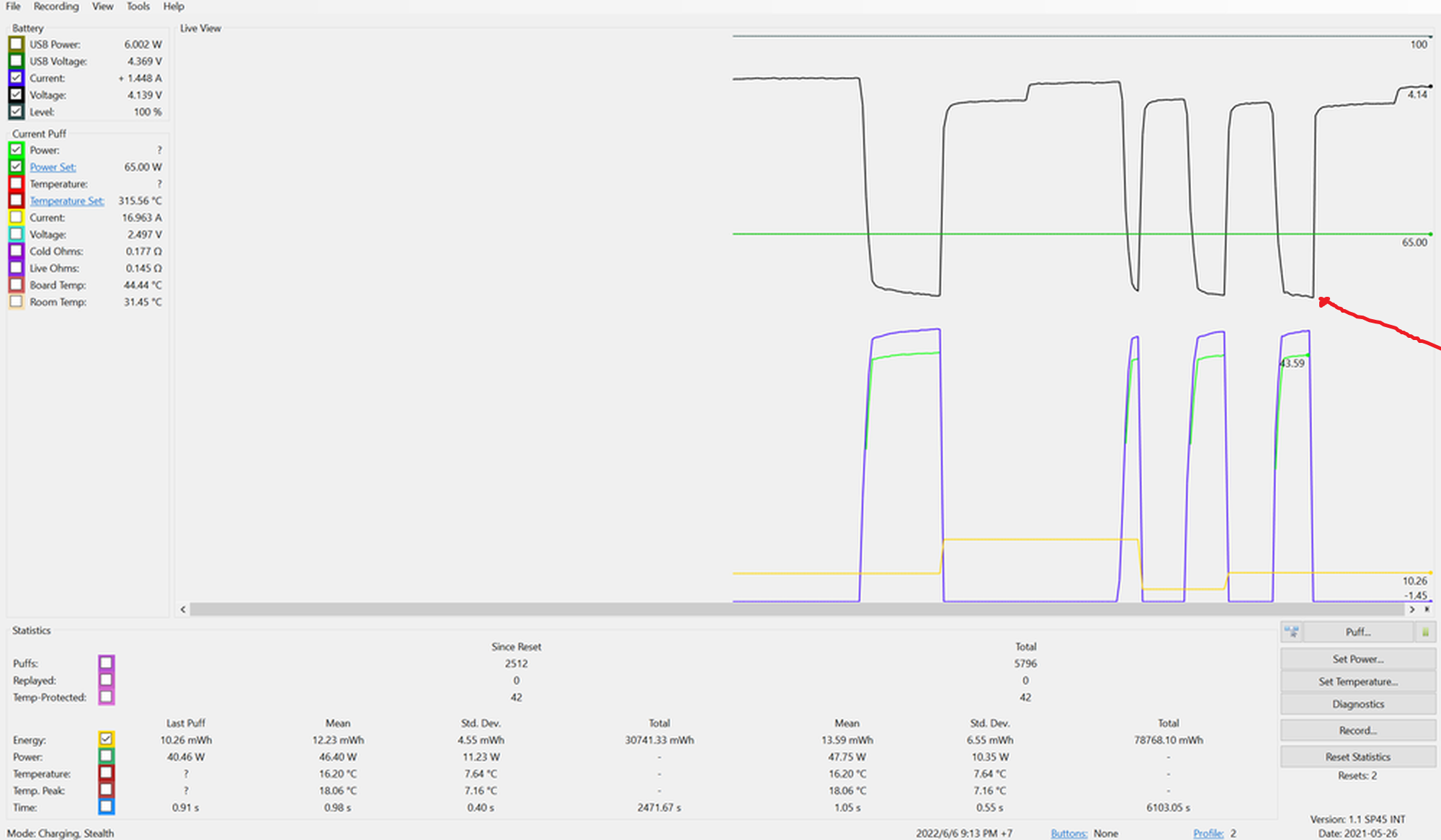

Here is a snippet of my SS316 coil firing in Devise Monitor, while your resistance may be different. Notice the percentage change from cold to hot. Also use Atomizer Analyzer to see that your atomizer is making a solid connection. It should have a good connection before it bottoms out. -

Hoover your mouse over the area indicated by red arrow. That is the voltage drop on your cell when firing. Report back to us what that voltage is.

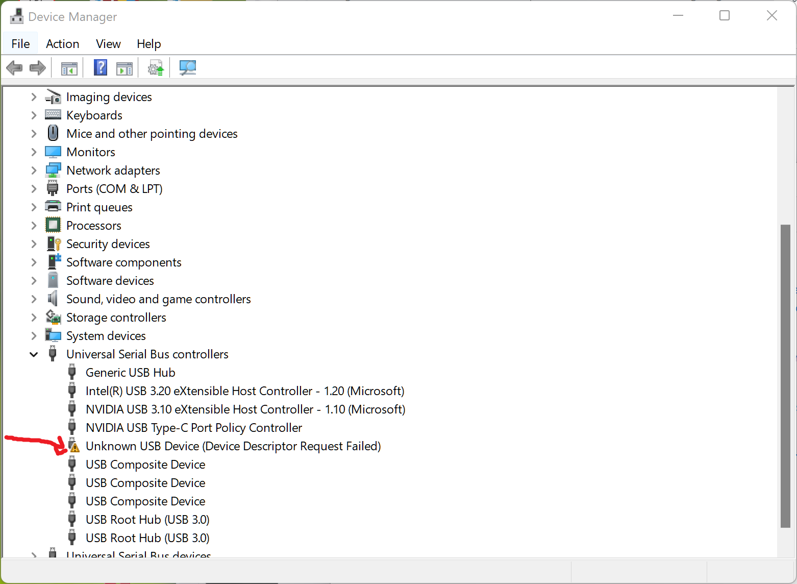

Look in Windows Device Manager when connected to the non C. If it looks like this Windows sees it but doesn't know what to do with it, no drivers, ect. If it isn't showing up then the device isn't communicating with Windows for what ever reason.

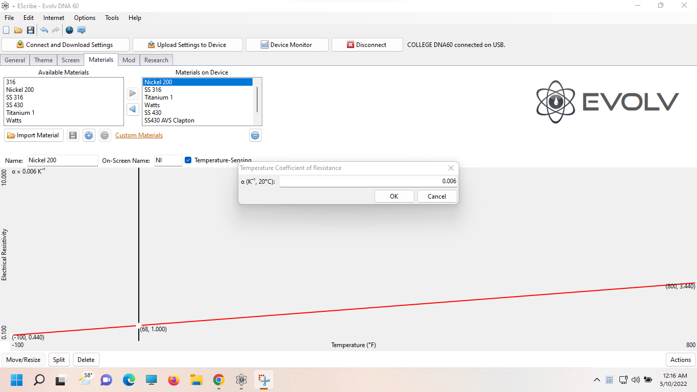

the I believe that you are wanting to change TCR directly on the mod but it can be changed for various wire type in EScribe under the Materials/Action tab. (Just incase that you weren't aware of it) -

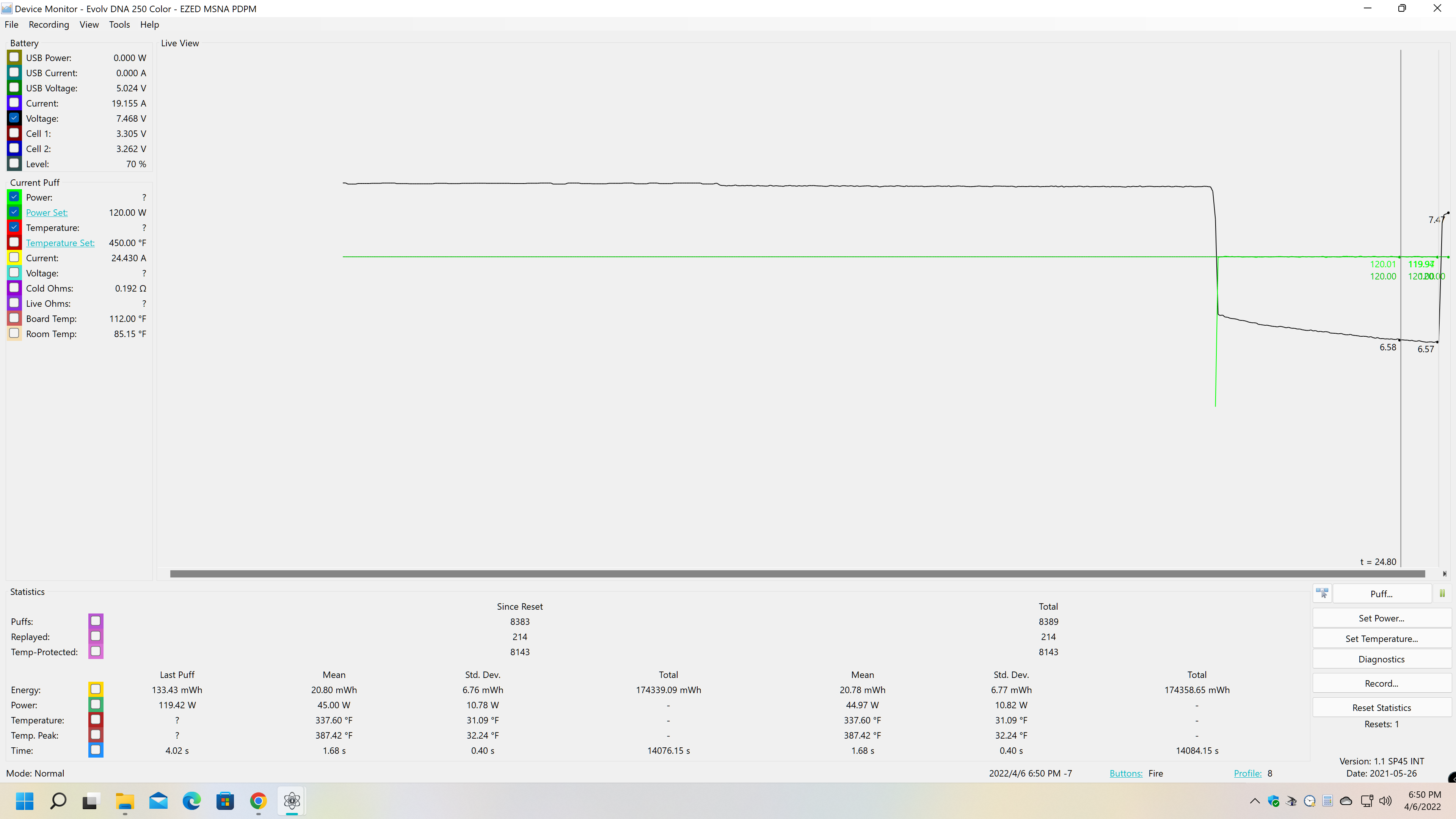

Is it a weak puff just for the first puff when mod comes out of sleep or is it weak every puff? A screen shot like this one will be most helpful.
Here is my DNA250C with two 18650 Samsung 20S cells @ 67%, 3.8 volts per cell standing at start, firing at 120 watts. Cell Soft Cutoff is set at 2.75 volts so no throttling should occur till cell voltage drops below that. Battery sled contacts are clean. Here throttling would start at voltage drop of 5.5 volts and it's only dropping to 6.57 volts.

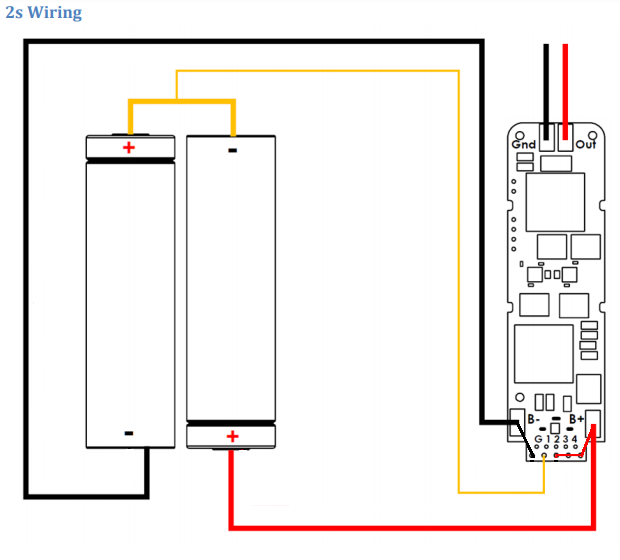

Jumping the balance connector to B+ and B- is how I wire a 2 cell 200/250 EDIT: It appears that I grabbed the wrong image as this is a DNA 250C but just disregard pin out #4 -
