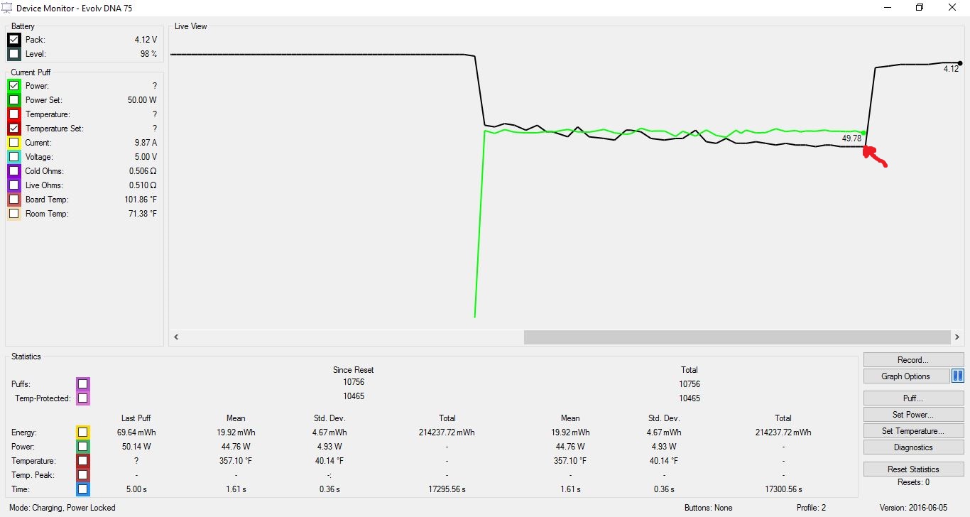

  18. dwcraig1
    Efficiency 85%??
    At the red arrow...it is 3.61 volts. This is with a LG HD2. Firing for 5 seconds.

  24. dwcraig1
    Efficiency 85%??
    I think a screen shot of Device Monitor showing battery sag while firing at 50 watts would go a long way here at determining the problem here. I use a SMY75 with LG HD2 18650 that fires at 40 watts/50 watts preheat 1 second and have no complaint regarding battery life. If there are connection problems between the battery and board or weak battery this can be seen by the sag.
