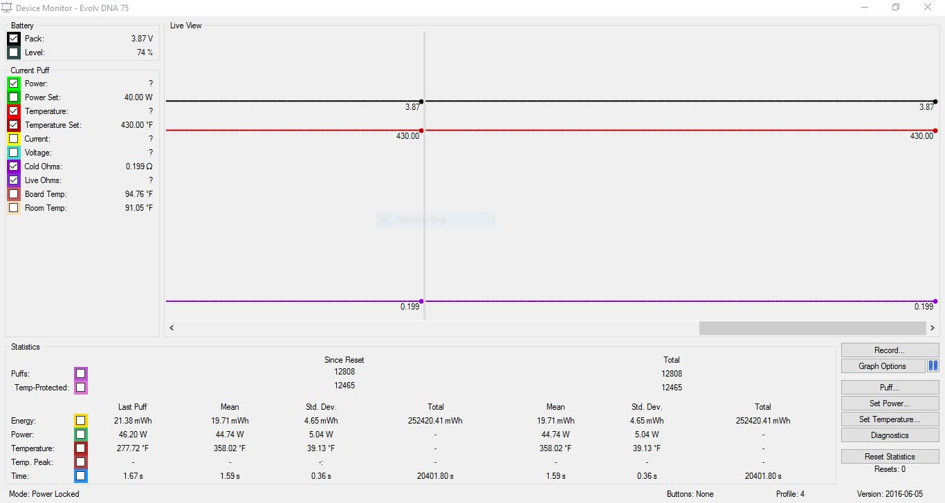

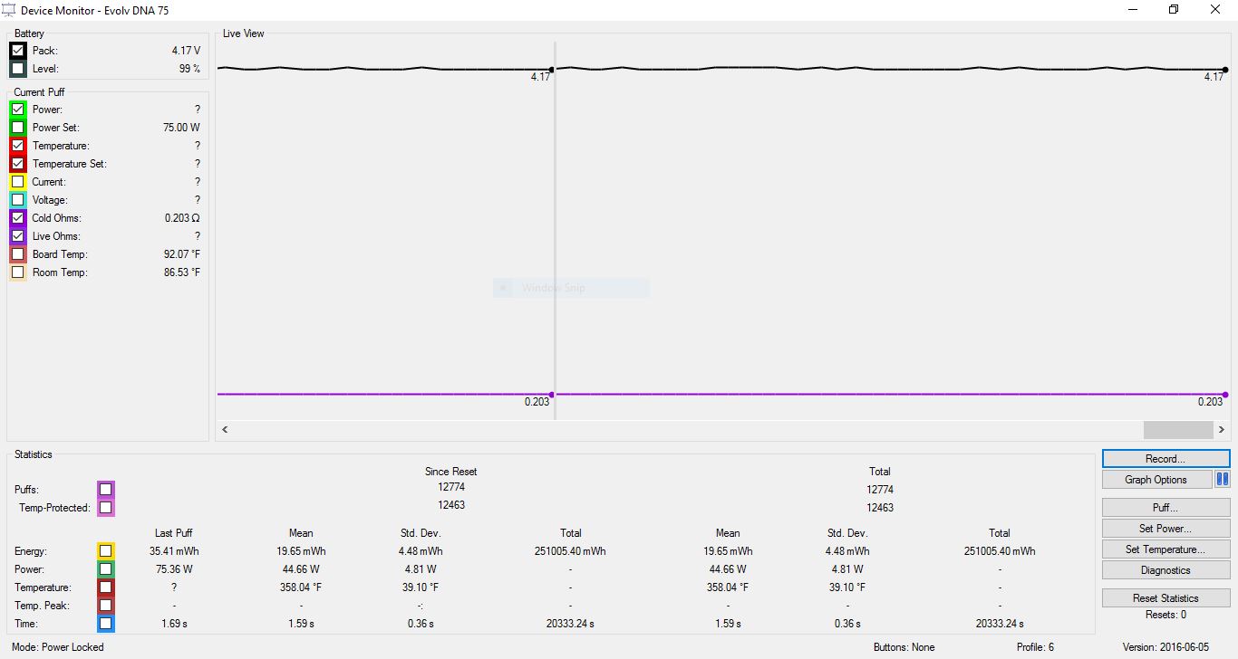

  23. So I set out to test my SDNA75 with LG HD2 18650 with my Velocity @75 watts....I eventually gave up (at 34 drags) as it just isn't my thing but here are the screens at the start and my finish. It seemed to do quite well I thought. But the flashing battery icon was coming soon...@ 2.75 volts.
  24. Probably better than average.
