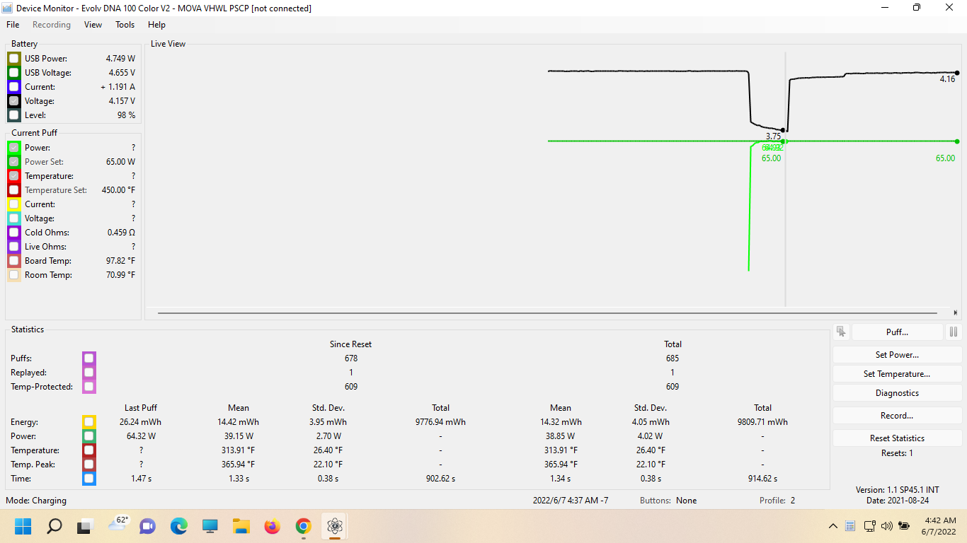

Here is a snippet of my SS316 coil firing in Devise Monitor, while your resistance may be different. Notice the percentage change from cold to hot. Also use Atomizer Analyzer to see that your atomizer is making a solid connection. It should have a good connection before it bottoms out. -

Hoover your mouse over the area indicated by red arrow. That is the voltage drop on your cell when firing. Report back to us what that voltage is.
