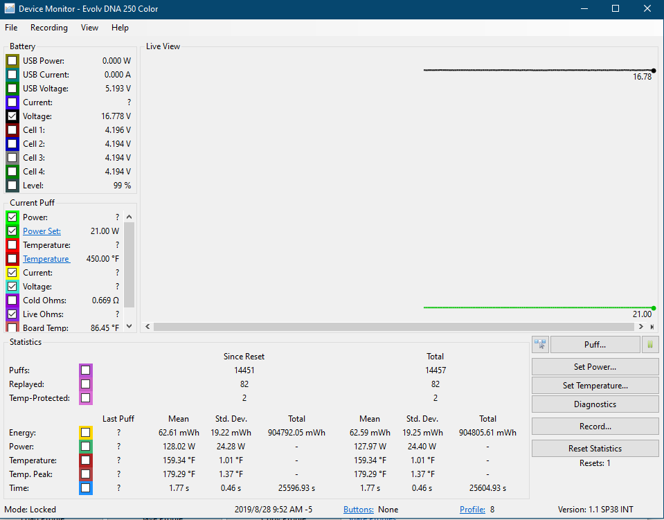

  6. The 70% peak may be a CSV file thing but the balance issue may be a battery internal thing or a charger circuit thing in the device. But you say you can externally charge the battery and it is balanced at 100%. Screenshot of my 4 cell completely charged in the device. Shows 99% charge reading. My Battery is not the same one as yours.

  10. Not many folks have a 4 cell 250C. Your cell 3 seems to be out of balance in the screenshot. You might compare this CSV file to your CSV. Save your battery CSV file and load this one (attached file) if you want to see if that helps or you can run battery analyzer to create a CSV for that battery pack.. Screenshot of my 4 cell 250C while still charging: 4cellcsv.csv

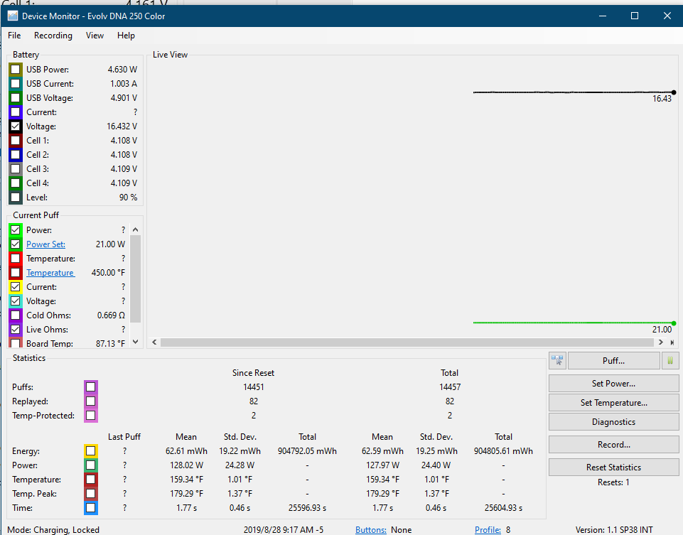

  13. Follow these steps: Plug device into Escribe and open Device Monitor (no atty attached) Lower left corner (LLC in later instructions) should say Normal or Charging. If it also says Locked then click the fire button 5 times. Press fire button once. Voltage drops. No atomizer message in lower center of Device Monitor. Press and hold adjust button for a second or 2. No Atomizer should appear to the right of Mode in LLC (toward the center of the line, not close to Mode section). Adjust message seen in the Button: category. (lower section of Device Monitor). Press fire button 5 times. Mode should show Locked (in either Normal or Charge Mode. Press fire button and voltage should drop. Press adjust button and where it says Buttons it should say “Adjust” Press adjust button 6 times… may say “adjust” or “none” beside Button… no change in voltage while clicking 6 times. What are your results compared to this description?
  14. What happens when you take off the pod and repeat the process you described. What do you see in Device Monitor? What does it say in the lower left corner of Device Monitor?

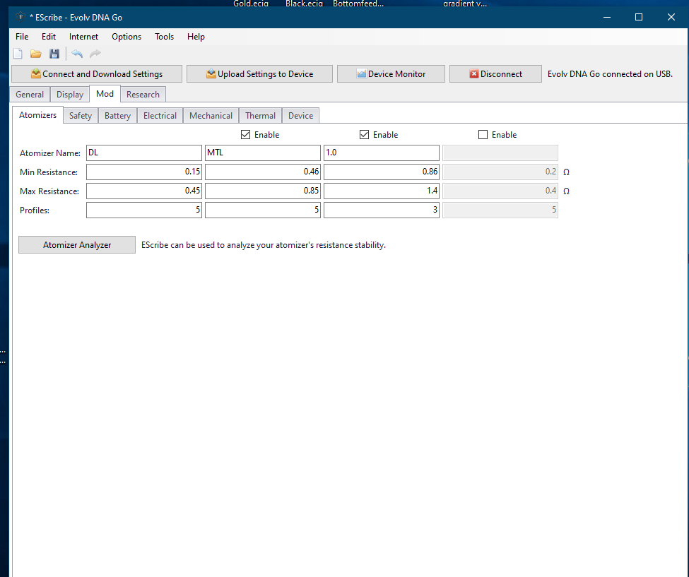

  16. You might look under the mod tab and see if 1.0 is enabled.... The instructions say: Make sure the software installed is the V2.0 SP20 If you still need help see the last page of the instructions for further help.. INSTRUCTION-UPGRADE SOFTWARE-ORION DNA GO.pdf
