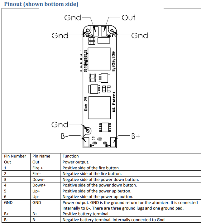

Here is the data sheet for the DNA75C board...... You posted this in the DNA250C Modders Forum..... I will move it soon to the 75C Modders Forum.... Welcome to the forum.... https://downloads.evolvapor.com/dna75color.pdf
Yes those are for external buttons (user supplied). Leave device buttons in place on the board. I assume the picture is showing a DNA 75 board which only has Fire, UP, Down buttons(no select button). Here is the diagram (pin out) for the DNA 75 Here is the complete Data Sheet for the DNA75: https://downloads.evolvapor.com/dna75.pdf The pin out is different for the DNA75C (color) as it has Fire, Up, Down, and Select buttons.
