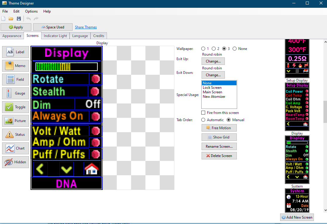

  5. I thought that article was probably not correct. There is a stealth mode in the Theme I use with my 250C devices. Here is a screenshot of one screen in Theme Designer. So with the 250C you turn Stealth on and off from the menu. I think Stealth only works when firing the device as you need to see the screen to use the theme. Here is another part of a reddit post I see: Although they do have a lock. But the screen will light up in either case. There is a stealth mode, but it is only stealth when you fire it and not in the menu system.

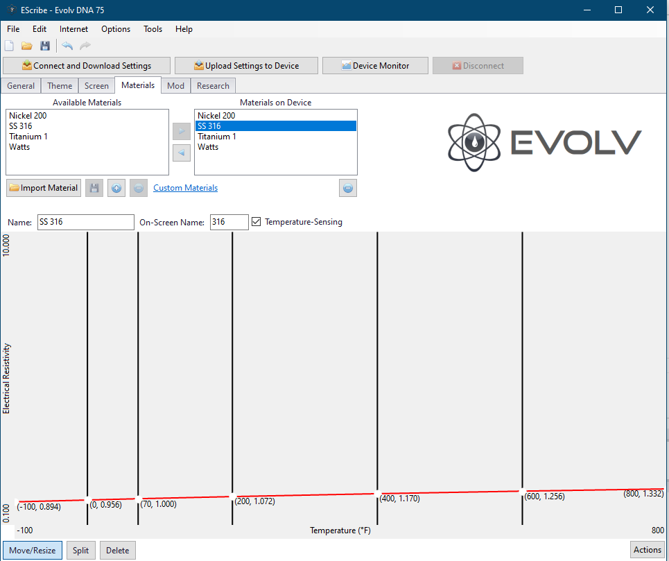

  16. Try using the SS316 material.
  17. Post a screenshot showing the n316L V3.5 material Example screenshot:
