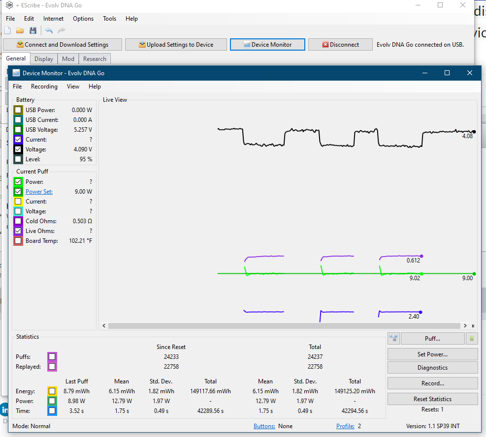

OK... I am concerned about 3 things. 1. The board temperature is too low showing only 42.71 F. 2. You have had the device for 1 week and vaped 7000 puffs. How many puffs did it have out of the box new? 3. The wattage shown while firing is too low and not as smooth as it should be. Many things can cause this. Here is a screenshot of my DNA Go device set at 9 watts... You have started a ticket with Evolv. It is the weekend so they may get back to you in a few days when the work week starts.. They warranty the board, not the device. If they decide to look at the board they will guide you on what to do. You might send another ticket to Evolv and include the last screenshot you posted. I shows the 3 things I listed. Since your device is 1 week old I would try again to get the seller to replace it. That would be the easiest especially if the board is good but the device assembly is faulty. That's the best I can troubleshoot without having the device as you say both atty's you tried are functioning properly. Good Luck and just for your info we are not employees of Evolv but just help if we can.
