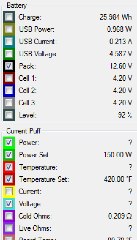

Can you post a printscreen (the entire screen) of your Mod tab and Device Monitor while firing. Printscreen With Device Monitor showing you just hit the "prt sc" button on your computer. Open a Paint software program and click on "Paste". You can change size, orientation, and etc. in the Paint software. Save this to your computer. Attach the saved file to a post here. OR (if you press [ALT]+[PRT SCN], open MSPaint and paste [CTRL]+[V] you have a screen shot from any program, that you can save and upload) OR Sniping tool AND what are these errors you've mentioned
Damn. Can you post a printscreen of your Mod tab and Device Monitor with the following boxes ticked.

Well, those cells look/looked imbalanced. Battery issue. Keep an eye on that, or try charging till they're all the same value, or recovery charge which takes a long time. Isn't that the mod with those easily replaceable lipo battery packs? Post another screen shot, same as before. -
