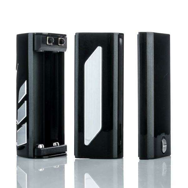

hi all, i get the new vt250s from hcigar, some crazy with my box...
i start use it in 2 cells config and all goes fine limit 167w ok....
so i tried the 3 cells config and madness starts the box stuck on max 167w with 3 cells
pluged and loged on EScribe so i check up in monitoring screen and the box only read 2 cells (yes the back on the box its close right)
then i put the last dna250 FW and reboot after few reboot and some profile mod magicaly the box start read and use the 3° cell and get 250w max power...
now more crazy i go back to the 2 cells config and the box show me the mess : check battery. and
does not work more with 2 cells.
logged in EScribe i can swich from 3 cells to 2 cells...
some one can help and post the original firmware?
i need to wait a new dna250 firmware or the last one can fit box like the vt250s (2/3 cells)?
i can fix that problem via EScribe or i must send back the box and ask for new one ,maybe old model?
