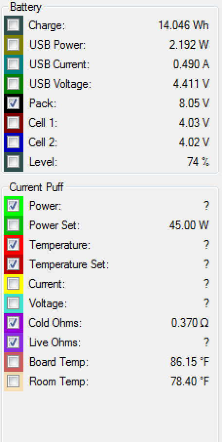

  8. @imfallen_angel In your 1st Device Monitor screen, it shows your room temp ~68F, board temp ~117F, that's about 50F difference, probably from the batteries. If you could do another print screen, and put that movable vertical where it shows the most sag, and report to us that value. The mod resistance is on your battery tab showing .004 which is a perfectly respectable value if it is correct. Although the Mfgr should set it, and perhaps they did, it doesn't mean it's correct for your individual mod. Quick 5 minutes for you to validate. "I did the mod resistance test, which is part of why I locked it ..." I think you meant you locked the coil ohms/resistance lock. The last 2 lines of my post were a direct copy/paste from the DNA75 datasheet published by Evolv. I trust their words and have never locked my resistance ever. "I already tried the Steam engine profile, the default and the 0.00092 value with absolutely no success" So many moving pieces from your posts, I'm attempting to start you from square one with a solid setup. You really do need to run your own 'thermal characteristics' for TC to work accurately. Either you wiped reset them to defaults, or Lost Vape never populated the values. Either way, doing your own, while 3 hours is long, will be the most accurate. I've done it for each of my DNA's. "Where I run the same tank/build on a chinese mod at 340F, on the Therion I have to be over 500F... that's way too much a difference to be "not as accurate" here." I agree with you. It is crazy, but not hopeless. Your mod seems fairly new (less than 1000 puffs), and probably still within Lost Vapes 6 month warranty, but I think it's too early to call it a faulty mod. So ..... do you wanna get it done right, or you happy with "At least right now, it appear to be stable with the settings I have on it" Edit: "But one thing I can say is that after just a little while (maybe 1/2 an hour of vaping), my batteries (that I left in the Therion overnight to charge) are already down to about ½." And you're sure these are new Authentic LG's? I vape at double your wattage on the same batteries for much longer on all my mods.
  9. Well your mod thermal characteristics are "evolv's" defaults (not set up, or you reset them) Your batteries probably some old ones and heating up under load (50F in the first pic) and is running out of power or hit the soft cell cutoff. AND you're locking your resistance so the board cannot refine the cold ohm value My suggestions: Buy new batteries from the Mooch approved listRun your own 'mod resistance' - 5 minutesRun your own 'thermal characteristics' - 3 hoursDownload 316L profile from Steam Engine, or use the evolv default or Djlsb value of .00092DO NOT LOCK OHMS if your resistance is solid. If they're jumpy, fix your build.Resistance lock: The DNA 75 relies on the cold resistance of the atomizer to measure temperature accurately. If the connection is not stable or if you find the measured resistance drifts with time, it may be desirable to lock the atomizer resistance
  10. Thanks man, I knew I forgot to mention that
  11. Alrighty then, so it looks like your coil needs somewhere around what your 'power' line shows (inverted green 'v') to maintain that temp. If that's sort of YOUR typical coil build, you can lower those maximums to more reasonable values. If you don't want as quick a ramp up, lower your punch slowly till you find your sweet spot. Once you set your 'thermal' calibration, it gets even more consistent
  12. @VapePanther do ya mind 1 last DM print screen for sh17s and giggles If you're getting nic'd out ... rest mod beside you ... bottom right hand corner .... puff for 4 second.
  13. @VapePanther You posted profile 1 which looks good for TC. Your Device Monitor showed you were using Profile 2. Please Device Monitor while firing showing Profile 1
