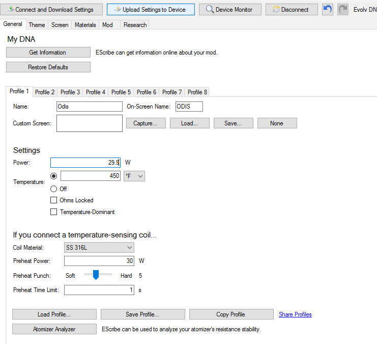

  2. Perfect. Every image shows that your mod is set up properly (not evolv defaults). Which would then lead me to ask if you've checked the build is still stable (since that Auto Fire) in Atomizer Analyzer (General Tab), bottom left. With those wires, you'll notice changes as it applies very low power intermittently). Apart from that, you've supplied enough info for other eyes. Would you mind, just telling us Escribe version and Firmware version for completeness
  3. That burnt taste was because your mod was firing for that duration at the full 80 watts because of no TP. As to the 41297 value ....... can you make sure your 510 pin and all inside the 510 is clean and free of juice for starters. Can you post 2 more printscreens. Mod tab, better seeing the lower portion of the screen, not the upper. Material profile with SS316 selected in the right hand window. Edit: Your preheat time limit right now is set at 0. So you're not getting that at all. With some fancy coils, I'll use 2-3 seconds One last question - Do you remember that coil reading that same value 0.30?

  17. Battery analyzer really just gives you an accurate estimation of how much your batteries are charged/discharged. Your mod will fire perfectly fine leaving it at default. IMHO the cell soft cutoff is very important. The 75 has a hard cutoff of 2.5V UNDER LOAD (sag). I and many others use 2.7-2.9v with the lower value giving you slightly more run time before 'Check battery' warnings. With a single cell 75, I value Amperage over mAh. In a dual or more cell, I'll go with high mAh.
