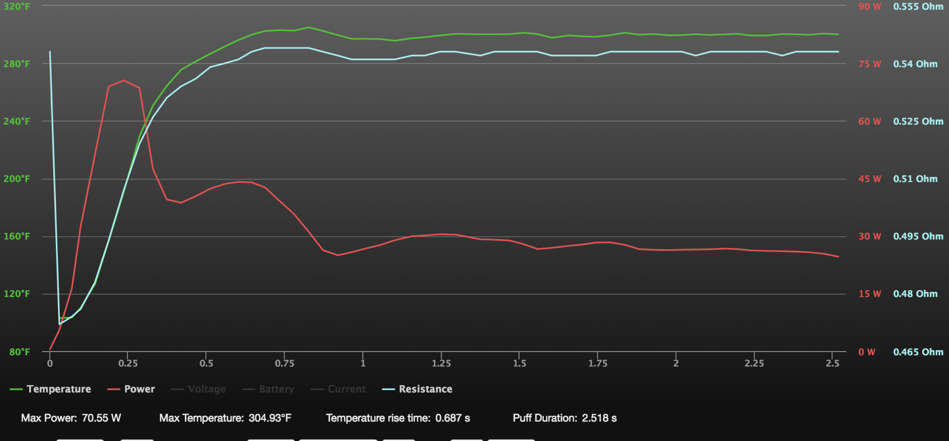

@jaygee Hereâs an excellent MacOS native monitor for DNA devices. Super fast, and quick. https://github.com/hobbyquaker/dna-monitor I find the display is much cleaner once you stop your vape, compared to escribe I have seen those âdropoutsâ infrequently while running escribe via Vmwareâs Fusion product, but only with 1 of my many DNAs. I think my only 75, but Iâm old and forgetful. That was one funky image you posted. Edit: In looking at your print screen again, could you humor me with one more at the following settings. No preheat, no punch. 25 watts. Same coil.
