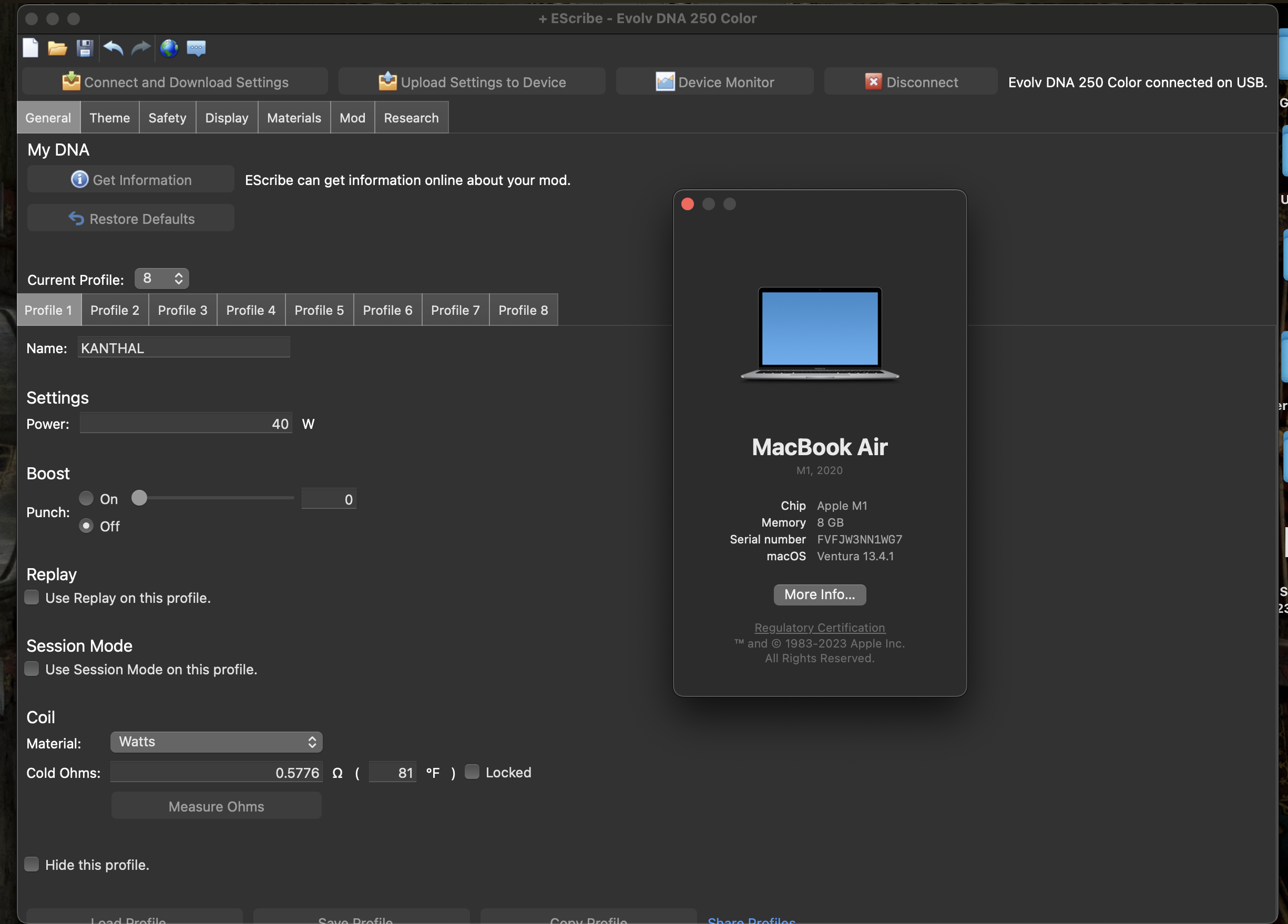

help Centaurus DNA 250c "Cant figure out the device version"
Wayneo replied to dupz's topic in DNA 250 Color
OK. Write what the two lines say directly above the OK line. Bottom right hand corner. What gives you an error message? And what is that error message.- 9 replies
Start escribe, under Help - About. Post screenshot. What more have you already tried?- 9 replies

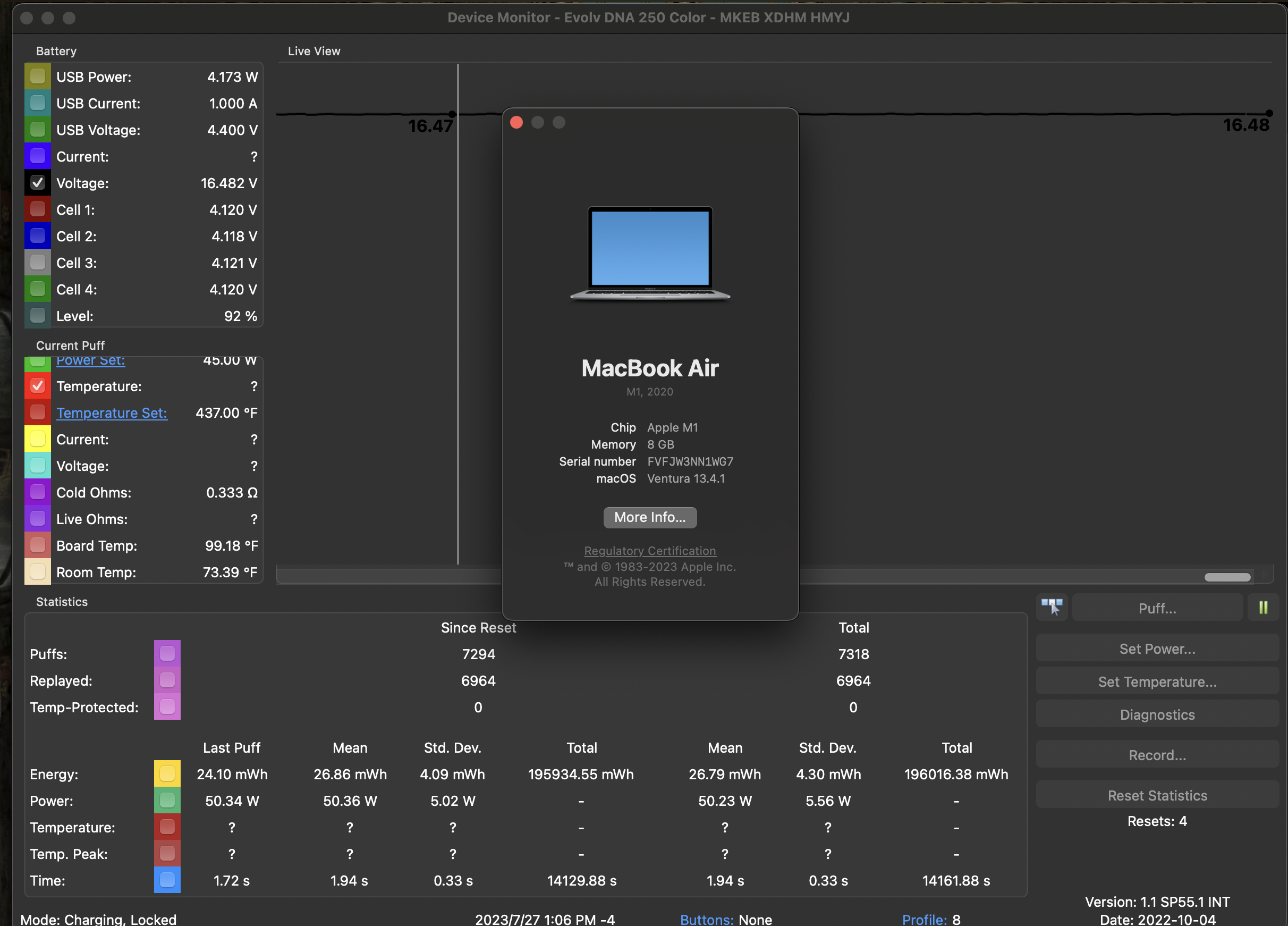

Need Help with DNA75 custom Mod - Display and Firing Issue
Wayneo replied to Decayed90210's topic in DNA 75
So what lead up to this? You were last using the mod minutes/hours days before, picked it up ......... Can you start up escribe with the mod plugged in, go into Device Monitor and do a full screenshot and post it here. -
