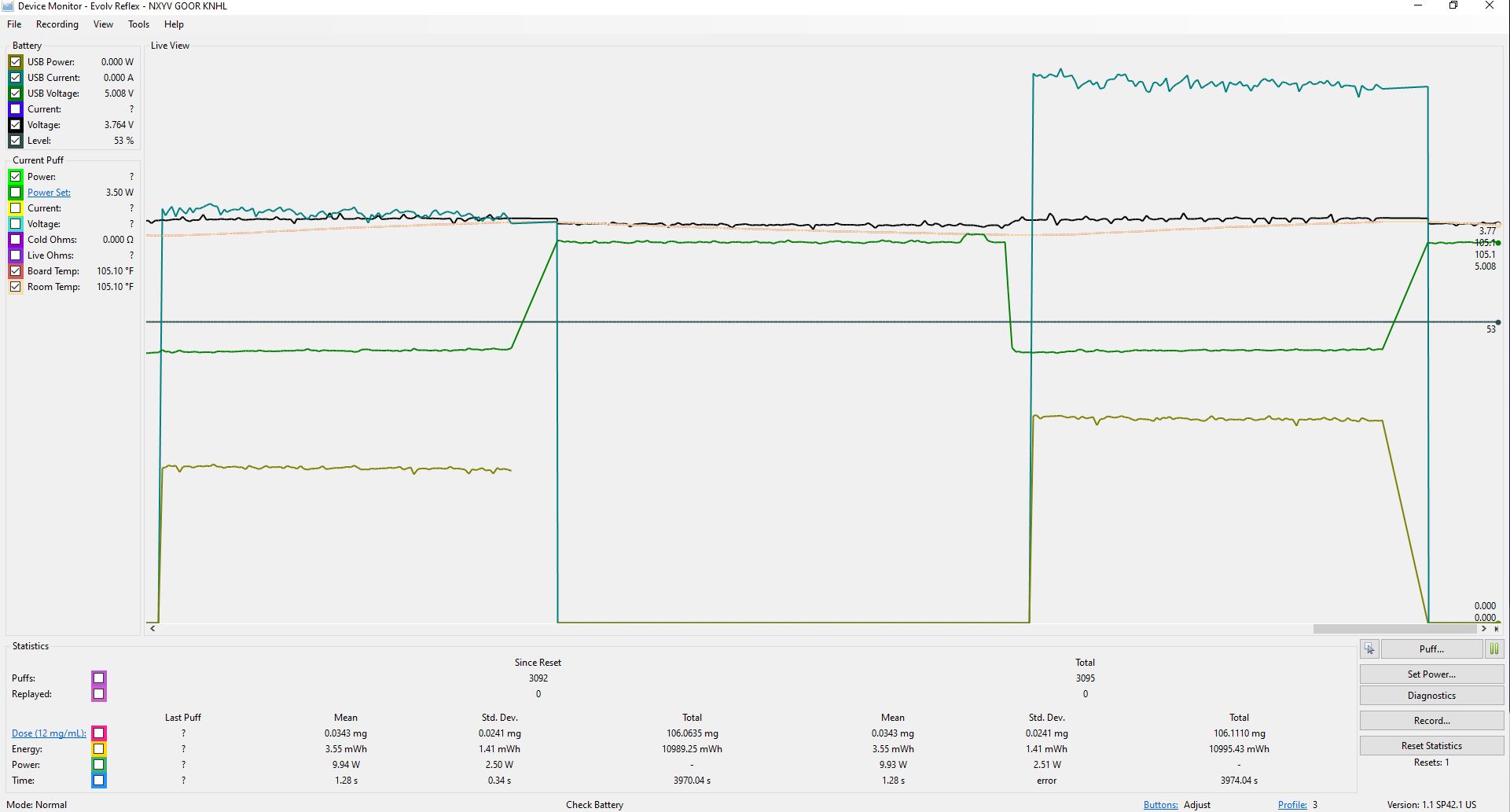

  2. My Reflex has already gone thru RMA, just waiting on the replacement device shipment to arrive. I just wanted to share my experience in the forum. I used Lava Flow nic salt 30mg (50/50 PG/VG) liquid in my Reflex I love the way it vapes. I cleaned the liquid below the pod during refills. After a few days of vaping with it, I started getting the 3 light problem on my Reflex. It stops vaping and displays 3 different lights (blue/green/red, then the reverse after some time) on the fire button. When I blew air thru the bottom vent hole and covered up the charging hole, some liquid oozed out of the led button, then it worked ok for a few hrs. This continued till it totally stopped working with the 3 light problem. Connecting to escribe showed the device connecting and disconnecting constantly. Device shutdown by blowing sometimes displays white light that goes off, or stays on for some time. It probably depended on when I blow air with the 3 light sequence repeating. I hope that I received a defective device (as suggested by Evolv support), and I dont face this problem anymore with the replacement. I kind-of suspect it is the liquid/juice seeping into the electronics compartment that resulted in the hardware problem. What liquid do you guys use with your Reflex? Do you guys recommend 60/40 or 70/30 juices instead of 50/50 to keep your reflex working?
