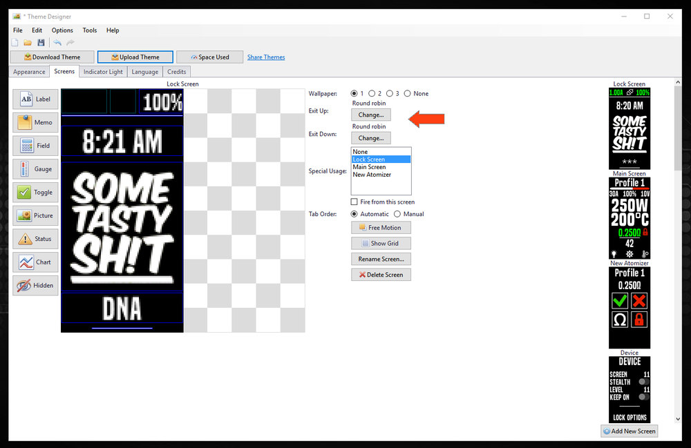

Wayneo Posted November 12, 2018 Report Posted November 12, 2018 On 11/6/2018 at 8:20 PM, James said: If you would like to try it, this experimental firmware (SP38) may fix the DNA 250C Error Press Up bug that was introduced in SP35. Let me know if you still get Error Press Up when using it. Expand @James , my mod with SP35 (told you about this earlier) did not exhibit this until after I created a new screen on the Evolv default theme and had it set to 'return to parent'. After changing that option to 'return to main screen' all is fine at SP35. That mod is still at SP35.

Vapors Tongue Posted July 1, 2019 Report Posted July 1, 2019 On 11/12/2018 at 5:59 PM, Wayneo said: @James , my mod with SP35 (told you about this earlier) did not exhibit this until after I created a new screen on the Evolv default theme and had it set to 'return to parent'. After changing that option to 'return to main screen' all is fine at SP35. That mod is still at SP35. Expand Reviving an old thread but i suffered the same problem with error up message every time i uploaded a theme or firmware to my device but everything worked as it should even though it displayed error up message , the device in question is a vapecige VT250C i now have 2 of them one gives this error up message the other one doesn't , i read this thread and tried Wayneo's solution as my lock screen hadn't got anything assigned to it so i assigned round robin and it fixed the problem of the error up message
