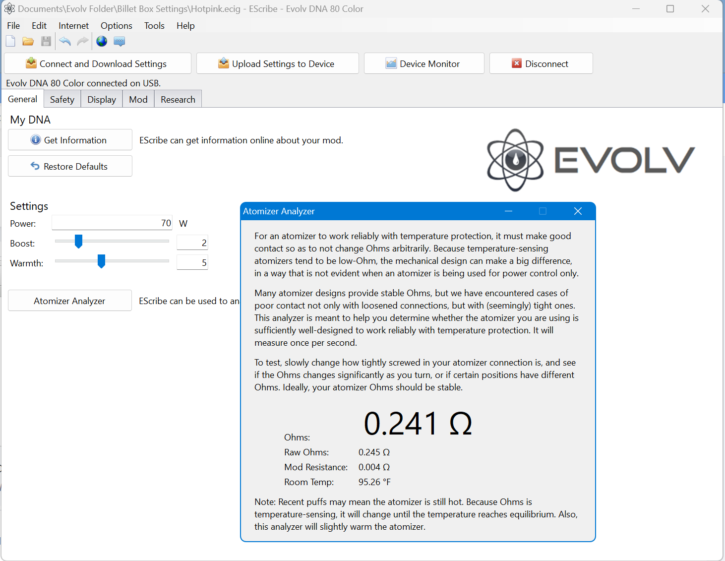

  14. also a pic of the atomizer analyzer
  15. followed your instructions and here are the results. the rba is a voltrove , it also happed in the stream crave meson boro tank . same results
