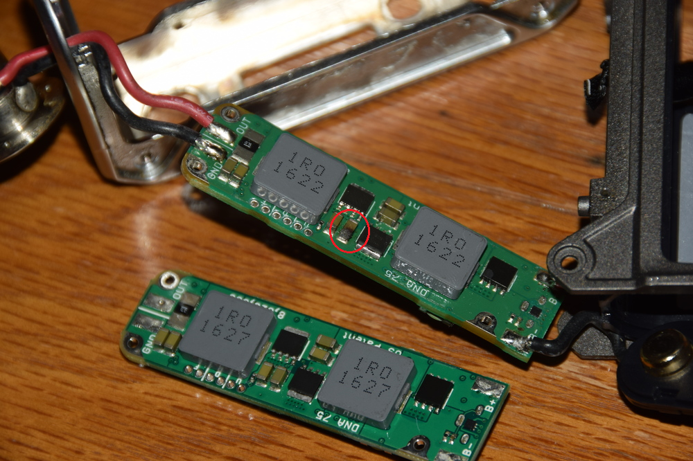

Most anything with a PCB (circuit board) has ceramic capacitors these days. These MLCC capacitors are notorious for failing due to a wide variety of situations, but mainly heat and mechanical stress (drops) are the big two causes. This type of failure is common to everything from our vape devices to cell phones and everything in between. These ceramic caps can fail full short to partial short. It sounds to me like you may have a cap on the batt rail that is partially shorted to ground. I suspect a lot of these "my device drains cells when idle" or "my device gets hot when idle" could be this very problem. No fault of Evolv's, it just the nature of electronics. That's where Evolv's or the manufacturers warranty comes into play.
Failed MLCC cap circled in red.......

I think I have the same problem with my therion 75c bf. the box has already been repaired by the service center that found a shorted capacitor. after a month of correct functioning the problem has arisen again and given the symptoms I think it's the new fault of the condenser in question. I looked at the component but I did not find codes, someone knows the correct value of capacity? sorry for my bad english

I was just going to chime in to say I have been down this road, and then I find you guys have my photos!! That burned chip photo posted above is my therion75bf (In fact I am sitting at that same table as I type this with its replacement a Thereon 75C BF right next to me). In the case of that one the mod would get noticeably warm all by itself and run the battery flat in 4-5 hours. I bought that one used, and the consensus was that juice must have gotten down into the board and shorted that cap. Evolve at the time told me this is a relatively common problem when they get leaks (and BOTH of my therions are perpetually leaky in the battery sled).
In any event, I was told at the time that I could send it in and apparently evolve is pretty good about warranty claims for this sort of thing, but I am in England and the shipping alone made it cheaper to just replace the board myself. So thats what I did.

@pierlu78 It's almost impossible to measure capacitance with the component still in circuit. Best bet is to remove a "known good" capacitor from the same area of the board (as it is unlikely both side-by-side caps failed), measure it's capacitance and size then go from there. The package size is most likely "1206" as for the rated capacitance, i don't know. You could just remove the damaged capacitor and see how the board behaves with just one capacitor. My guess is it wouldn't hurt. This theory only applies to either the 2 caps at the top (OUT) of the board or the 2 caps i have circled in red.
Shipping the board back to Evolv, for repair/replacement is too costly? I only condone working on boards if shipping the damaged board to Evolv is very expensive. EX.  People over-seas.
Posted
I know that in order to measure the capacity the capacitor must be removed from the card, for this reason I asked if anyone knew the correct value. I'll try to remove it to see how it works. send it to evolve for me is too expensive, I write from Italy. Thanks for the reply @ChunkyButt200
