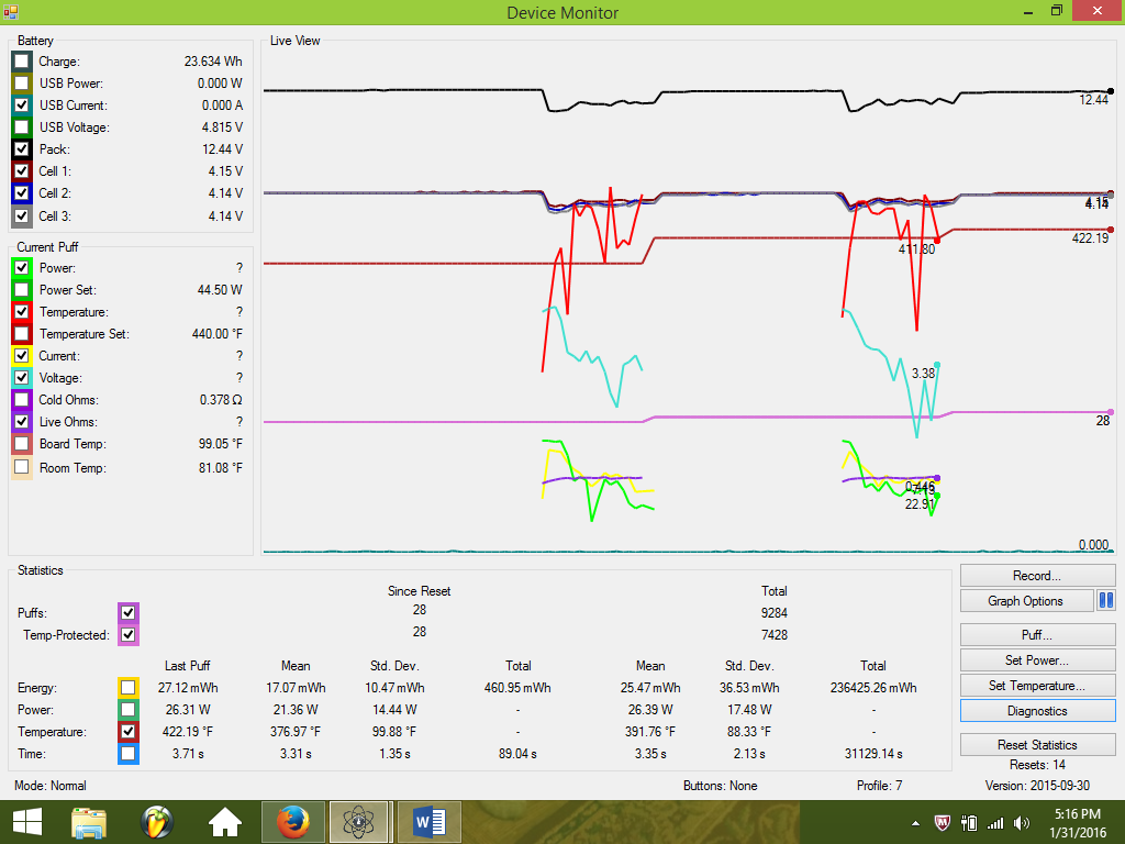

Bobby Posted January 31, 2016 Report Posted January 31, 2016 I am at the point that I am convinced the DNA200 is not working properly with TC on stainless Steel. I challenge anyone who claims that they have TC with Stainless Steel working well for them, to post a device monitor screenshot. Please, please proof me wrong!I get a good vape with SS in power mode or in TC mode when I set the power and temperature setpoints at such levels that TC never kicks in (but the last mode of vaping is essentially the same as the first).When the power and temperature settings are so that TC kicks in and is regulating the power, it is doing so erratically (see: Post #19 in This discussion). I get the same erratic results no matter what atomizer, SS wire, factory SS coils and profile settings I use.
Vaportron Posted January 31, 2016 Report Posted January 31, 2016 well it does act erratic if you have your watts too high. you can get a nice rip with low low watts watch temp in device monitor climb and climb.works good just not all the time or under .5 (IME)
Bobby Posted January 31, 2016 Report Posted January 31, 2016 @Vaportron Sorry to break the news to you but you are not vaping with TC!I mentioned in my previous post that I get a good vape with SS in power mode or in TC mode when I set the power and temperature setpoints at such levels that TC never kicks in. The last one is what you do; If you look at the power in your screenshot, it is a flat line so TC is not adjusting the power to maintain the temperature. What you do is in essence the same as vaping in power mode.If you take a look at my post #19 in This discussion you'll see that I can do the same as you (bottom picture) but I also show the problem the DNA200 has when vaping SS with TC regulating (top picture)I continue to challenge anyone who claims that they have TC with Stainless Steel working well for them, to post a device monitor screenshot. Please, please proof me wrong!

Vaportron Posted February 1, 2016 Report Posted February 1, 2016 so i increased my watts and it looks like thistc is working even though it looks erratic.whats your actual problem?
