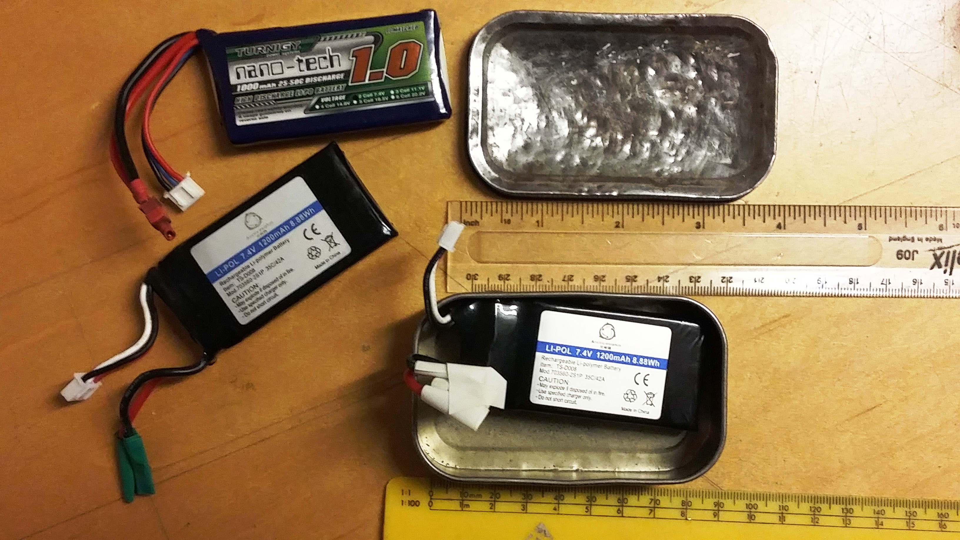

black lace Posted March 26, 2016 Report Posted March 26, 2016 I cant put an arguement up because i aint built one, but to be perfectly straight i have three twin cell lipol batteries at 1200 mah 8:88 Wh measuring 68mm x 33mm x 4mm at 7:4 volt, i would be keen to use them if possible. But simply because i think i could get them squeezed as a parallal pair into a strepcil tin, and also these tins are or have a slight indented face and back so i could polish it then inlay a bit of timber veneer i have.

black lace Posted March 26, 2016 Report Posted March 26, 2016 I did somthing of simular size in a hammond for someone but with a dna 30 clone, i'll edit the post with a picture of the tin and batteries when i get to a computer,, unfortunatly the tin has seen better days but it would be a nice bit of fun mod with a disstrest look and paired up with a little dripper and nanno coils like a hobo or brass monkey or even a mini rtda like a goblin, a 3ml aromatizer might look a bit posh for it, lol, pic to follow... i only vape myselfe on avarage 11watt on a sigle coil rta all day vape and 30ish watt on a twin coil rdta, and at this moment im using a twin coil goblin mini on :30guage loose twisted kanthal, and 18 watts is all it needs with 1:50mm coils at :46 ohm, so a 3ml tank would marry up nice to a little battery mod, old tobbacco tin.. blar dee blar ect lol..

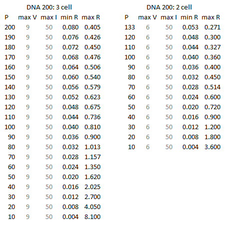

VapingBad Posted March 26, 2016 Report Posted March 26, 2016 This came up elsewhere, but thought I should also put it in this thread.Kanthal limits from R = P/I.I = V.V/P(I think if you want to convert to temp limiting numbers you would use to the hot resistance to match to a row on this table, not 100% sure I will run the numbers with Ni sometime to check.)
black lace Posted March 27, 2016 Report Posted March 27, 2016 thanks for that, plenty of time to get my head round it,,, the kantal thing I was on about was pretty much a one off but worked well, stuck for time with a back log of attys piling up waiting to be cleaned and rebuilt, I am very much tc, (for the miles of ni200 and nife30 on the bench) but stuck for time last night I resurrected a little rdta and threw it together with some, I suppose macro coils , a bit of resistance with kanthal, found it was way to hot and out of control on a mech mod, also resurrected,I should think we all get a little set in ones ways when having a few mods and attys collecting, that we build to the atty on that particular mod and don't divert to much, , I had almost forgotten the benefits of simple wattage control through the dna200,,, anyway, got a decent vape within minutes and haven't put it down all day.
