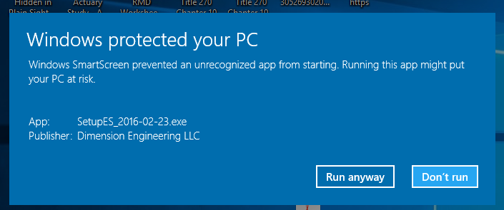

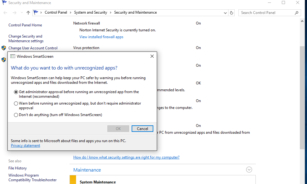

retird Posted February 24, 2016 Report Posted February 24, 2016 Updated to the latest test firmware of yesterday. When I downloaded the .exe file my Norton Internet Security said the .exe file was safe. When I clicked on the .exe file to install EScribe I get the following (using Windows 10, 64 bit). I click "Run Anyway" and install EScribe without issue. The firmware update from within EScribe works just fine. All is good but just wanted to post the Windows warning I got each time I ran the .exe file. CLICK on "More info" and you get this screen: Picture from Windows Control Panel shows settings for Windows SmartScreen: ( Control Panel/System and Security/Security and Maintenance/Security/ Windows SmartScreen/Change Settings) Easy to change setting you want to use for unrecognized apps....
James Posted February 24, 2016 Report Posted February 24, 2016 retird: We reissued our code signing certificate to SHA-2 so Windows 10 would recognize it post-2016. (The earlier 'corrupt or invalid signature' people were experiencing is Microsoft... stretching the truth... to force developers off SHA-1 certificates.)It's a new certificate, so SmartScreen should recognize it as "safe" in a day or two. If we had paid extra for an "extended validation" code signing certificate, of course, we would have gotten "immediate reputation". Protecting YOU... from people who don't pay them enough. Good times.
retird Posted February 24, 2016 Report Posted February 24, 2016 Great.... thanks for the info... at least this discussion allows folks to see this is not an issue to be concerned about...hum.... Microsoft?... that's another story.....Have a great day James (and associates)....
