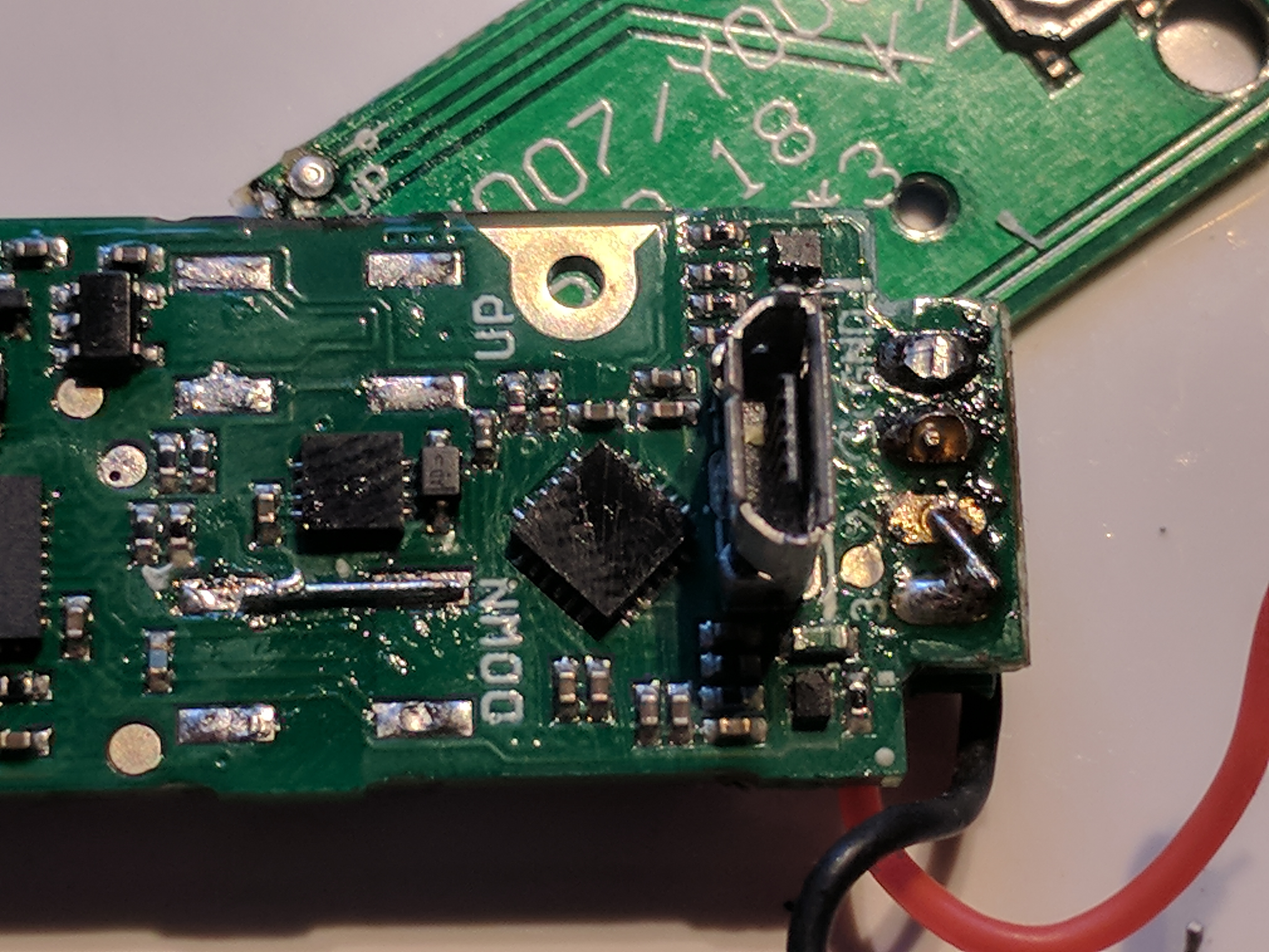

  4. I understand, so I just need to bridge the Down and Fire button like in picture 1 to use 3x external buttons correct?
  5. If you look at the first pic, you can see the Fire and Down button bridges. The Up button wasn't bridged. I'm only interested in the UP/Down/Fire buttons, not the Power/Battery bridges for 2S/3S configurations. Why does that effect the Up button?

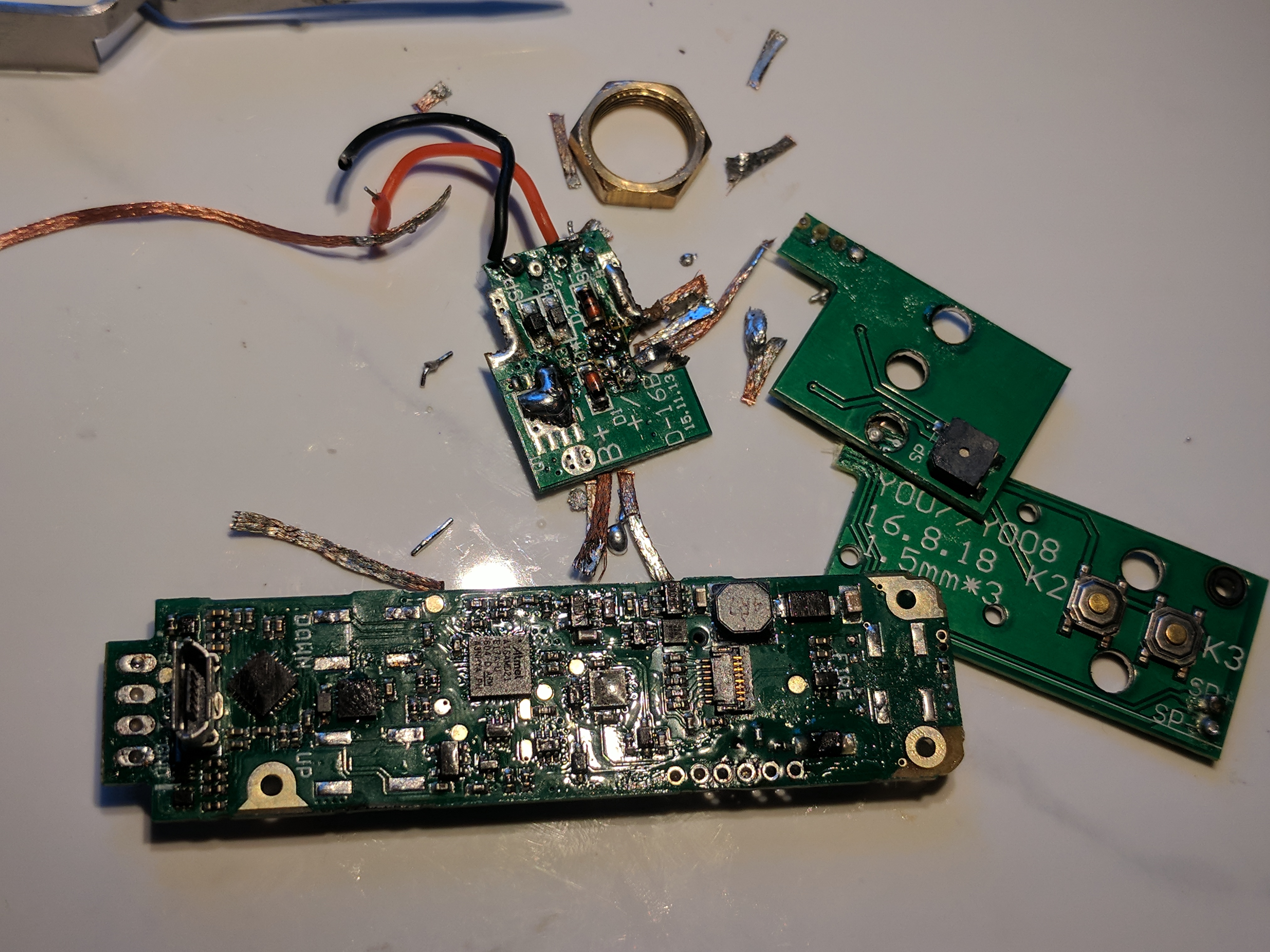

  9. I have a Vapedroid by S-body with a defective daughter board. S-body has mutilated the poor DNA board with terrible soldering, 2 daughter boards and removing the up/down/power buttons. The fire and down button had a bridge. I would like to know if the bridges are needed to use external buttons when removing the onboard buttons. Chip has been cleaned and is ready to be built into a proper mod.

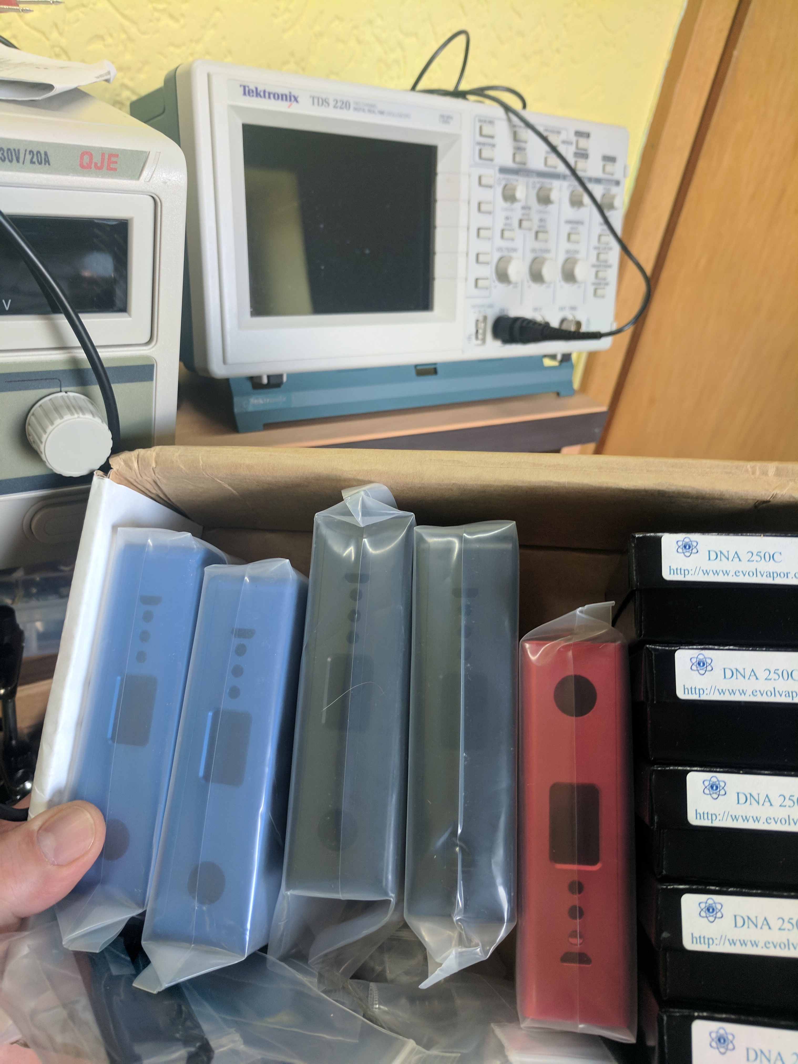

  11. On the red box in the attached picture, where the onboard fire button/LED rest I'd like to drill a hole to bring out the onboard LED. Has anyone any proper suggestions to what LED light pipes / plugs to use?
