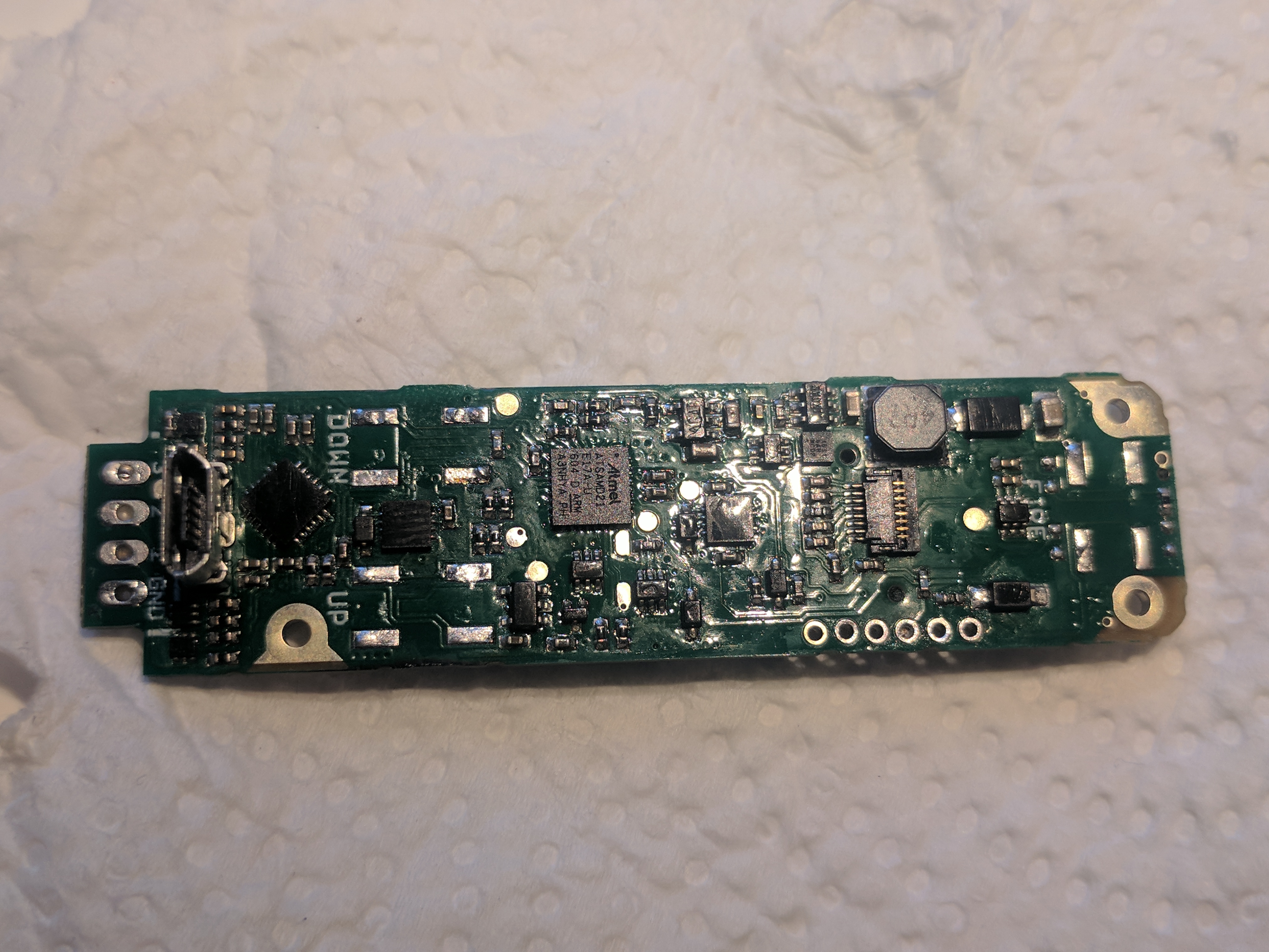

  4. I understand, so I just need to bridge the Down and Fire button like in picture 1 to use 3x external buttons correct?
  5. If you look at the first pic, you can see the Fire and Down button bridges. The Up button wasn't bridged. I'm only interested in the UP/Down/Fire buttons, not the Power/Battery bridges for 2S/3S configurations. Why does that effect the Up button?
  6. Thanks for the reply. I kinda figured they are needed, but the UP button didn't have a bridge. That confuses me as to if it's really needed or not.

  9. I have a Vapedroid by S-body with a defective daughter board. S-body has mutilated the poor DNA board with terrible soldering, 2 daughter boards and removing the up/down/power buttons. The fire and down button had a bridge. I would like to know if the bridges are needed to use external buttons when removing the onboard buttons. Chip has been cleaned and is ready to be built into a proper mod.

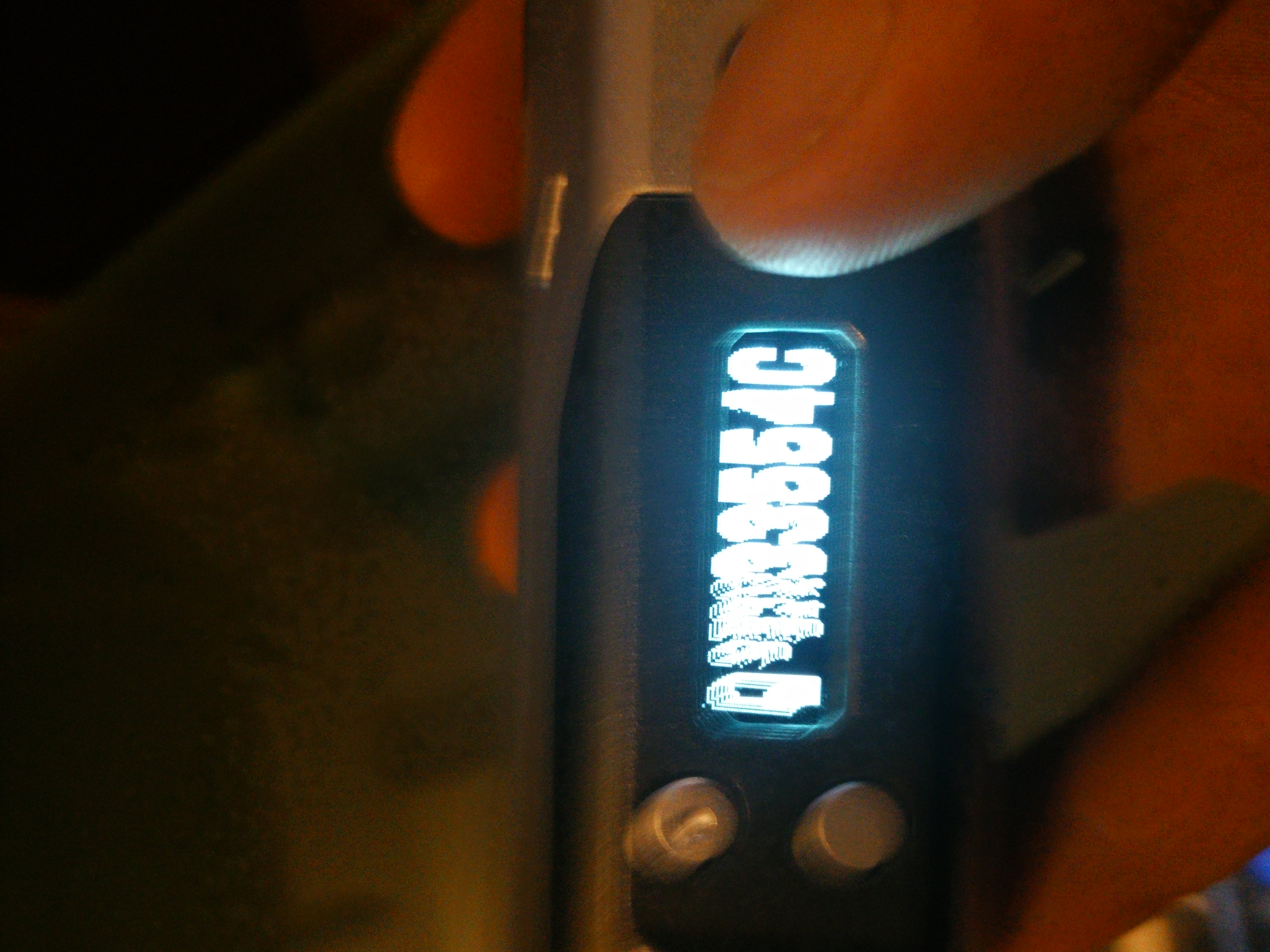

    I see, makes sense. I had built a .23 and it was a strange sight to see.
  13. MaDc0w
    TC bug
    I had a profile with ohms locked to 0.56, changed coils and forgot to unlock/set the coils properly to the new ohm value. When I went to hold down and fire, I didn't lock the fire and it fired shortly showing 33554 degrees celsius. Sorry for the terrible picture attached, but I don't want to try reproducing it as a safety precaution. Using firmware 2016-02-29 EScribe 1.0.42
