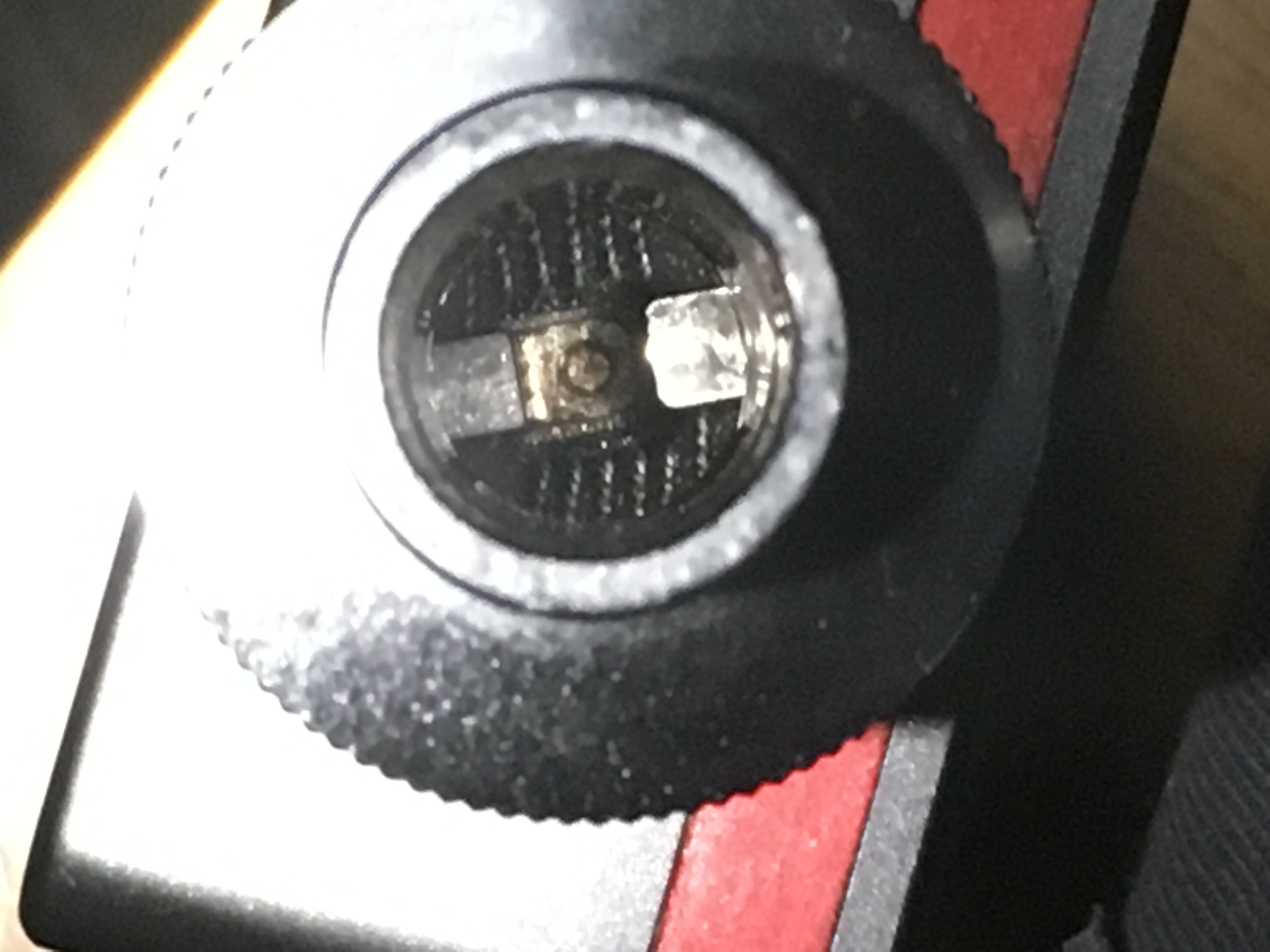

jarred.sayles Posted March 11, 2016 Report Posted March 11, 2016 lexalove said:You need to throw that coil away!Anyone using Ti wire... do not under any circumstances allow the coil to glow orange/red and if for any reason it does throw it away immediately.When Ti glows it oxidises and Titanium dioxide is a known carcinogen which can cause lung damage.Looking at your picture I would guess your last coil is a slightly bigger diameter than the rest of the coil and not coming into full contact with your wicking material that's why it's getting hot. I've done the same thing on numerous occasions with Ti coils. I always put a 90 degree kink in the leg on one side of the coil so both coil legs come out on the same plane, I've had no issues since I've started doing that. I just got my Griffin. I absolutely love it. I have started building To coils as well. Can you post a pic showing the 90° kink ur putting on one of the legs. As well as a pic of your setup. I am currently running dual twisted 28 awg @ 3mm that came out at .27 its doing great but sometimes I have problems getting the coils on the same plane as unmentioned above.Any suggestions and pi s will be appreciated. Thnx!
