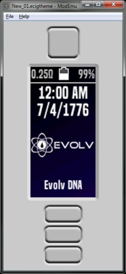

Scarab Posted May 5, 2017 Report Share Posted May 5, 2017 Well, i have a little idea. What if sometime we will have something like "Mod Emulator" - software for testing themes w/o loading it to the mod. For making test of UI logic and navigation.Something like this: Link to comment Share on other sites More sharing options...
mikepetro Posted May 5, 2017 Report Share Posted May 5, 2017 Me likes....... ^^^^ Link to comment Share on other sites More sharing options...
