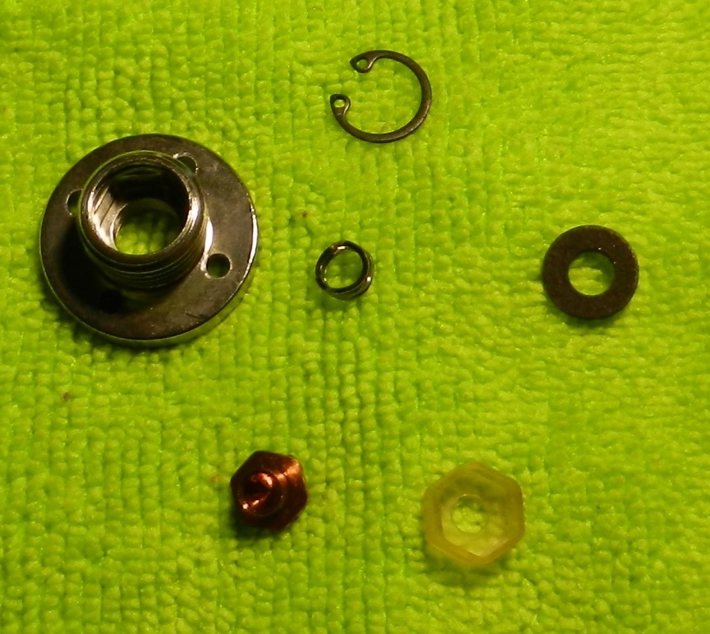

  13. I have to use it on some of my atomizers due to their varying resistance. On in particular will vary from adding .02 to .15 to the total resistance. With a .23 coil in, it vapes great with the base resistance, but when it reads .15 more it is unusable. I lock it in. For me this is a function of a weak 510 spring as the atomizer behaves with more pressure on the center pin.

  18. Usually that is a button that fights tight in the case or gets jammed or finally is too tight against the tactile switch.
