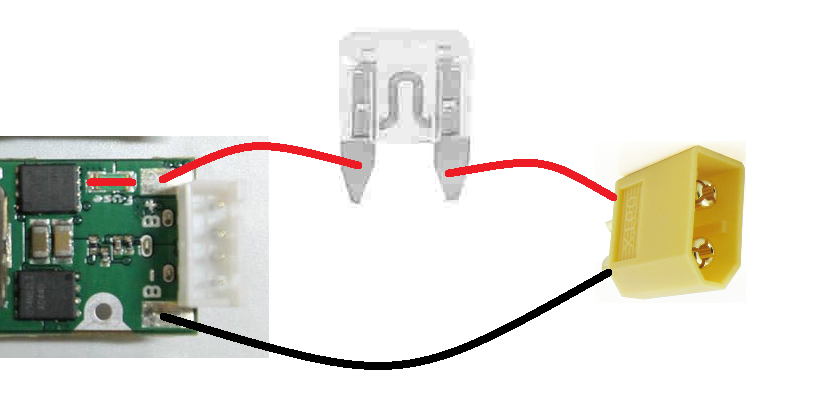

Fuse Blown.... Any Alternate
VapingBad replied to ziaibrahimadv@yahoo.com's topic in EScribe, Software and Firmware
The fuse is mainly to protect the battery from a short in the mod and the auto fuse will be fine for that, it will be a little slower to blow than the SMD one so not 100% as good, all I can say is go by what John and James said in the other thread, they both work for Evolv John designed the board and I James does the software. -

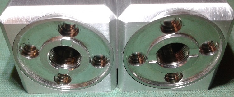

Evolv reference case
VapingBad replied to Russ ModCrate's topic in Connectors, Components, and Accessories
can you drill out the broken half of the screw from threading, then re-tap?[/QUOTE] I would need about 1.2 mm drill to be able to use a M1.6 tap after, I only have a Dremel pillar drill and the because the screw is a lot harder than the body and 1.6 mm drill bend easily I don't think I could do it. And there is not enough screw showing to grip. -
No, I don't do videos, atm they look like this, but the brushed one has a broken board mount screw so can't be used and I don't fancy my chances of drilling it out. ETA higher res of the inside -
I wouldn't advise anyone to do what I did and use the screws to cut the board mount thread, I sheared a stainless steel screw in the aluminium housing and have made on of my enclosures scrap metal. I tapped M1.6 threads in the 3rd with an HSS tap, I should have done that from the get go. -
Yes what John described is the same as the picture I did for you. -
I just got 3 of the Mod Crate boxes and am very impressed with the quality everything fits very well, you do need to sand the back of the buttons a little and the board mount holes are not tapped both of which are no problem at all. They come with hex socket screws for the case and torx 5 screws for the boards (1 set was black so I will uses ss ones I had already). I will post some more details and pics in a few days, just a heads up they did a great job. -
Please tell me if you are confident with the installation of automotive fuse, or not? because i have satisfied with your reply to this post. I prefers to install an automotive fuse because it (fuse blow) has been happen to my second device. I live in Pakistan and it takes more than 2 months for shipping and return from Evolv, due to the reason i am searching an alternate for changing the fuse. I have tried to buy the original fuse from: http://www.mouser.com/Search/ProductDetail.aspx?R=3413.0332.22virtualkey69300000virtualkey693-3413.0332.22 ebay and other vendors but they do not ship to Pakistan, therefore, i am searching for a good and authentic alternate. if there is someone who already have tried it and satisfied with its working, his opinion / experience would be very helpful for me as well as for others.[/QUOTE] It will work to fix the fuse, but if there is another problem that caused the original fuse to blow it will not fix that. Best to go be John and Jame's posts in this thread /topic/67186-topic/ -
Personally I would put a lower fuse on like 20 A because these will take longer to blow than the SMD ones, if you can find "fast blow" they would be best. But you have to understand that this is a your own risk, you could send the board to Evolv and get them to check it and replace the fuse. -
Wiring the auto fuse: you would just put it it the positive wire from the battery connector, just cut that wire and solder each end to the fuse. -

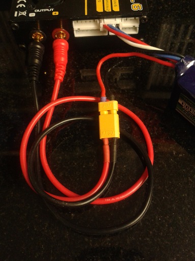

Charging Hcigar VT200 battery on Imax B6 Li-PO charger
VapingBad replied to kevmac's topic in Batteries and Charging
You normally have to buy or make the lead with these type of chargers as there are so many different types of connector, I think it is an XT30 charge lead you need for that battery to plug into the two 4 mm sockets with the balance plug going into the 4 pin socket white section on the side. Here is a picture (the plugs are not fully inserted to make it clearer for you)
