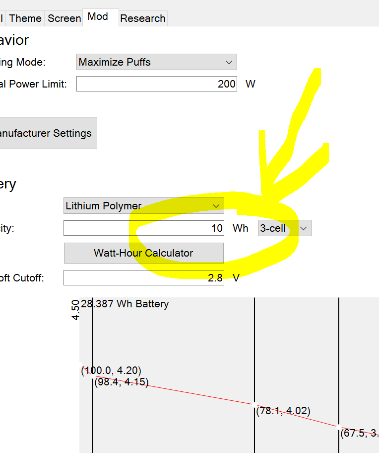

i just typed 10 in there for you to see where it goes. if you look on my battery curve you'll notice the watt hour is actually 28.XX. That screen shot (purely for demonstration purposes) is for my triple 18650 LG HG2 reuleaux. all my other dna200's with lipos are set at 3.09v for the cutoff. -

this is what should be input for your watt hour field or 9.9 using the calculator. either one will be ok to use. just making sure you don't have the wrong number in there. -
Escribe battery adjustment now does not full charge
Spector NS5 RD replied to CrashRecovery's topic in Batteries and Charging
where did you input 900? at the watt hour field in manufactures settings under the mod tab? 900 would be telling your dna 200 you have a 900 watt hour battery, lol. take a screen shot of this 900 number in whatever field you have it in. and post it here. i dunno if youre using the watt hour calculator and using that number or what, but 900 would be the mah of the lipo, which would equate to 10 watt hours using escribe's calculator. -

900 to 700? in the watt hour field type in 10.08. that's what i got when i ran battery analyzer. that seems to be more accurate. i'm almost positive the lavabox uses a fullymax 900 mah lipo. that's also the same battery i ran the battery analyzer with. i recommend running batt analyzer for yourself at an avg wattage you vape at for an accurate battery meter. i have noticed sometimes my devices will never get to 100% when usb charging. i fire the mod once while still plugged into a charger and that kicks the charging cycle back into gear and gets me to 99-100%. -
